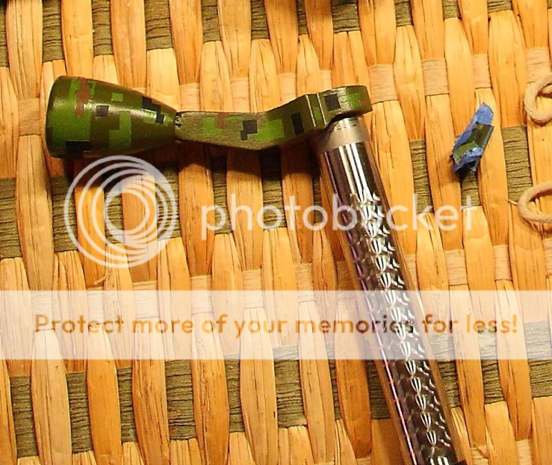

I'm painting my R700.
It has a stainless bolt
Can I paint the main tube and just cover the bolt head or would that affect any tolerances in the mechanism??
Also I would also want to sand it a bit to rough it up, that also ok to do?
I had a norc m14s with a baked on duracoat finish. the bolt stood up considerably well with very minor wear at the contact points. the lug bearing and bolt face was masked off to prevent painting them. That bake on duracoat is pretty damn good stuff
Sounds good guys. I'm using duracoat, pretty much the same as armacoat.
I'll give the bolt a paint then, I just wasn't sure at the time and didn't want to risk anything.
I'll cover the lugs up and give the remaining bolt part a paint. But I'll have to sand it first to allow for better paint contact.

Not a bad idea, I have a dremel with the necessary head. I'll see what works best. Duracoat recomments sanding with 600 grit so I'll see how that looks as well.
