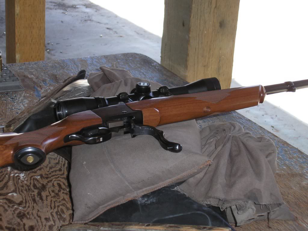

I have been paper patching for a No 1Mk 3 Lee Enfield and and Ruger #1, both in .303.

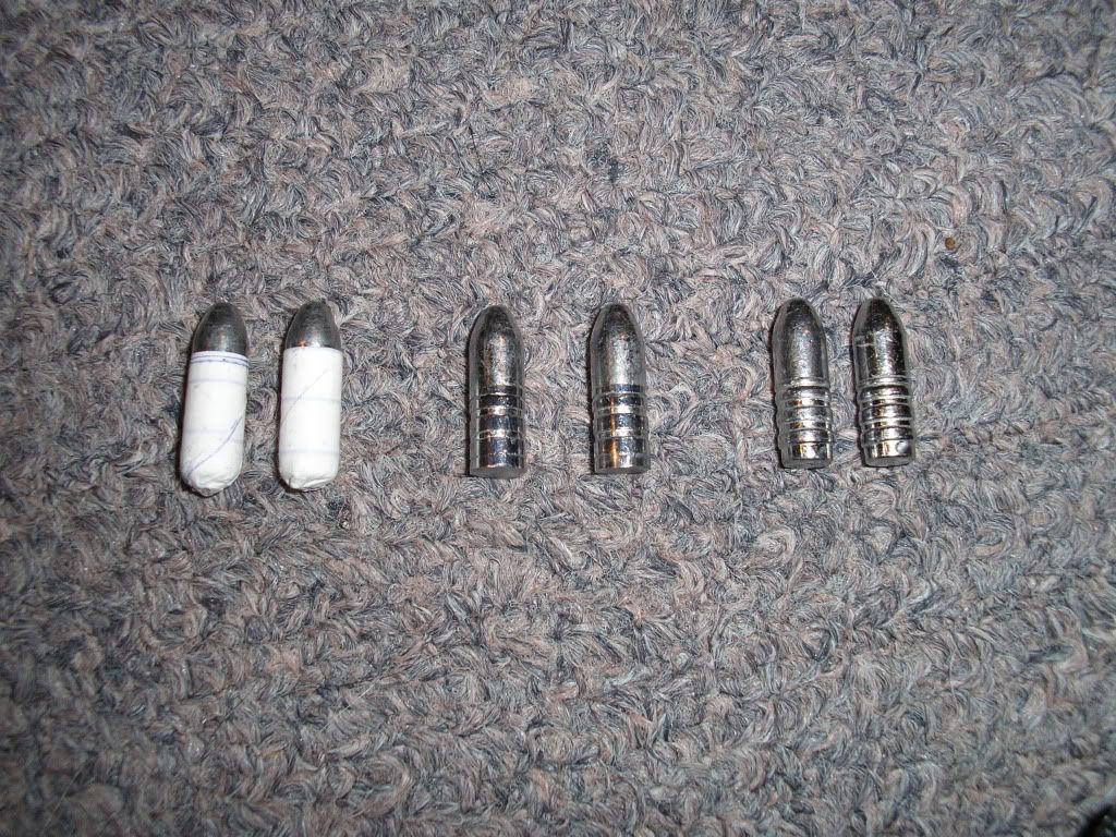

On the right is the Lee 180 grain .308 bullets as cast.
In the middle the same size bullets after sizing down to .304. Notice that the lead from the raised bands has been pushed back obscuring the gas check recess.
On the left are the sized bullets after paper patching.

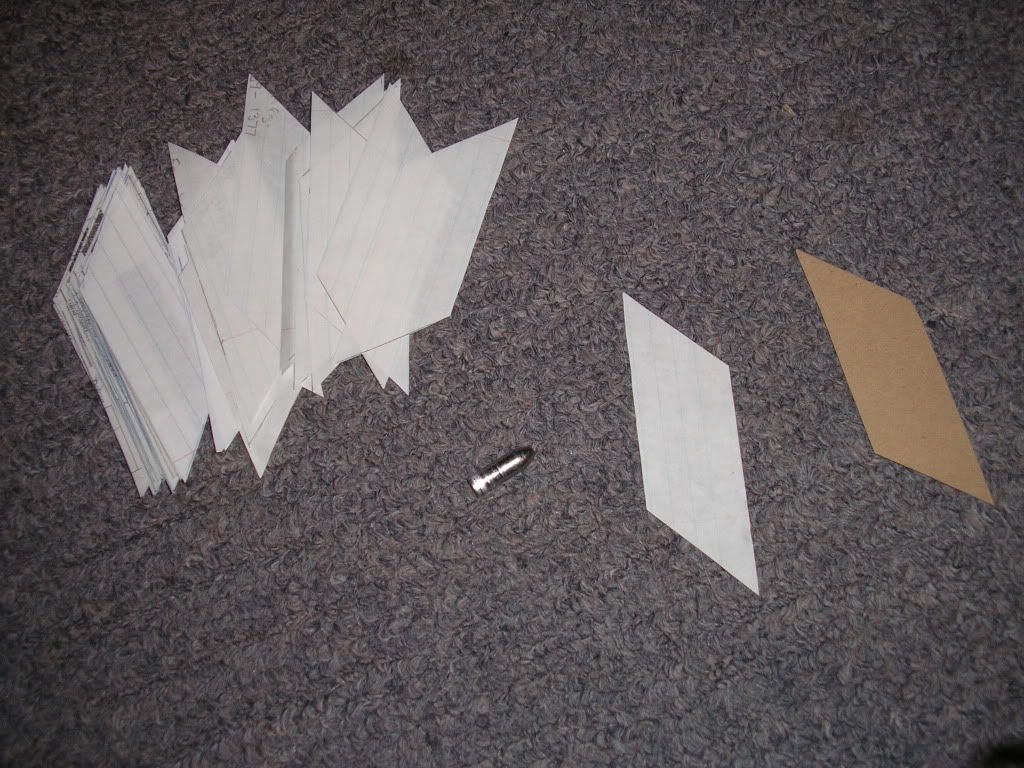

Cut patches and template with Lee 180 grain bullet for scale.
There are a number of different ways to paper patch. This is what I do.
I take a patch and soak it between two folds of a wet facecloth. Once it is soaked through I place it on a flat board and make sure it is smoothed out so it adheres to the surface a bit. The bullet is wrapped as tight as possible with out the paper tearing. Once wrapped, I twist the tail in the direction of the wrap and set the bullet aside to dry. As the patches dry onto the bullets they will shrink and harden so that they will not unwrap without some determined effort. The next day, when I am sure the paper is dry, I snip the tails off with a set of sharp side cutters.

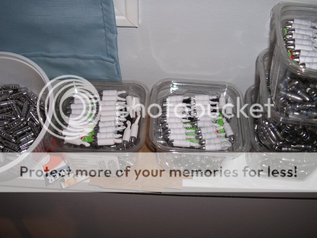

I have not used teflon tape, but I have wrapped .308 jacketed bullets in the thermal paper from shopping receipts. They measured .315 after wrapping and were just as accurate as my jacketed .313s.

For my Ruger, I had a special sizing die made to reduce a .309 cast bullet to .304. I then wrap it to approx .316"
I am currently waiting for a Lee .314 sizing kit to arrive so that I can do a final sizing before loading. Up until now, I have been loading patched bullets wrapped for a snug fit in a case fired from the same gun. My Ruger has a large diameter chamber, (.316") so the bullet has had to squish a bit when fired into the .313 bore. Accuracy has been best with harder alloys, but I don't own a chronograph and may be pushing the soft lead bullets a bit fast.

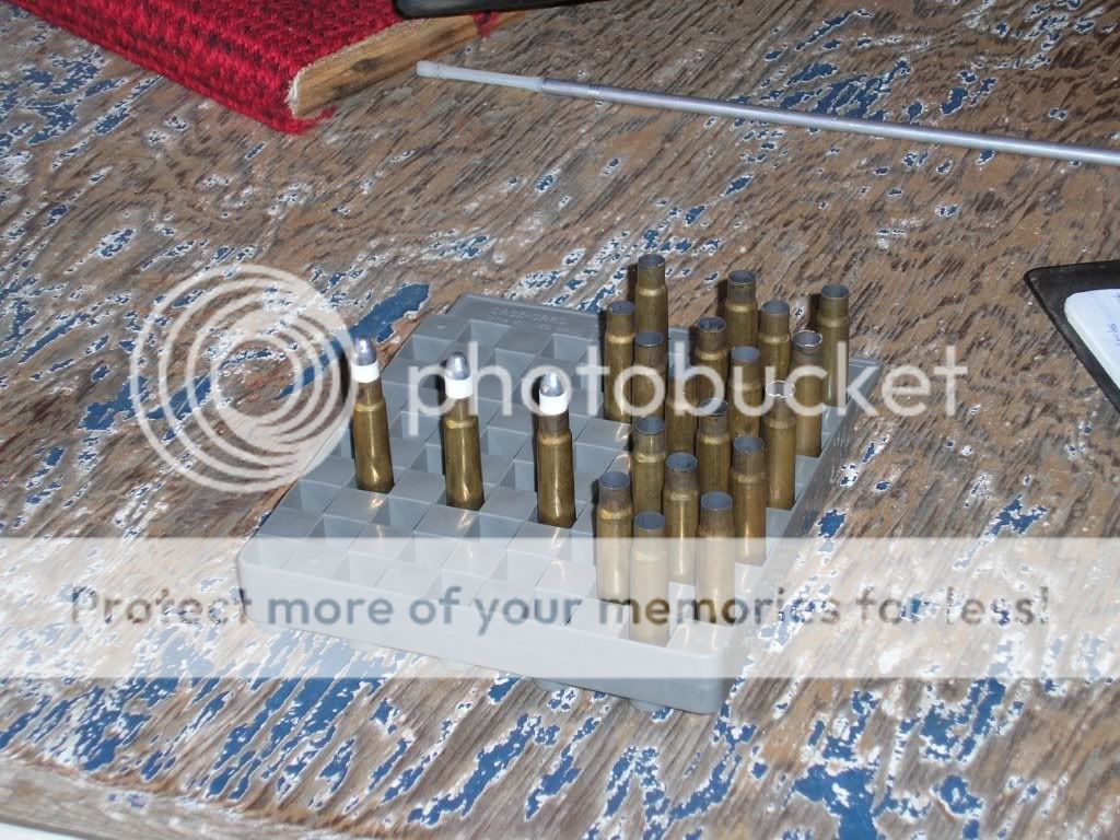

I have not used any .303 reloading dies and have been using an old Lee Loader in 30-06 to neck down the case so that the bullet is snug when hand seated into the case. I use slower powders such as IMR 4350 or 4832 that fill the case to the base of the bullet.

Being cheap, I have tried to use paper that I had around the house. This has not worked that well and I have probably spent far more on primers and powder than I would have spent on some good paper. My greatest handicap in the beginning was a lack of the correct sizing dies, which really limits what paper can be used.

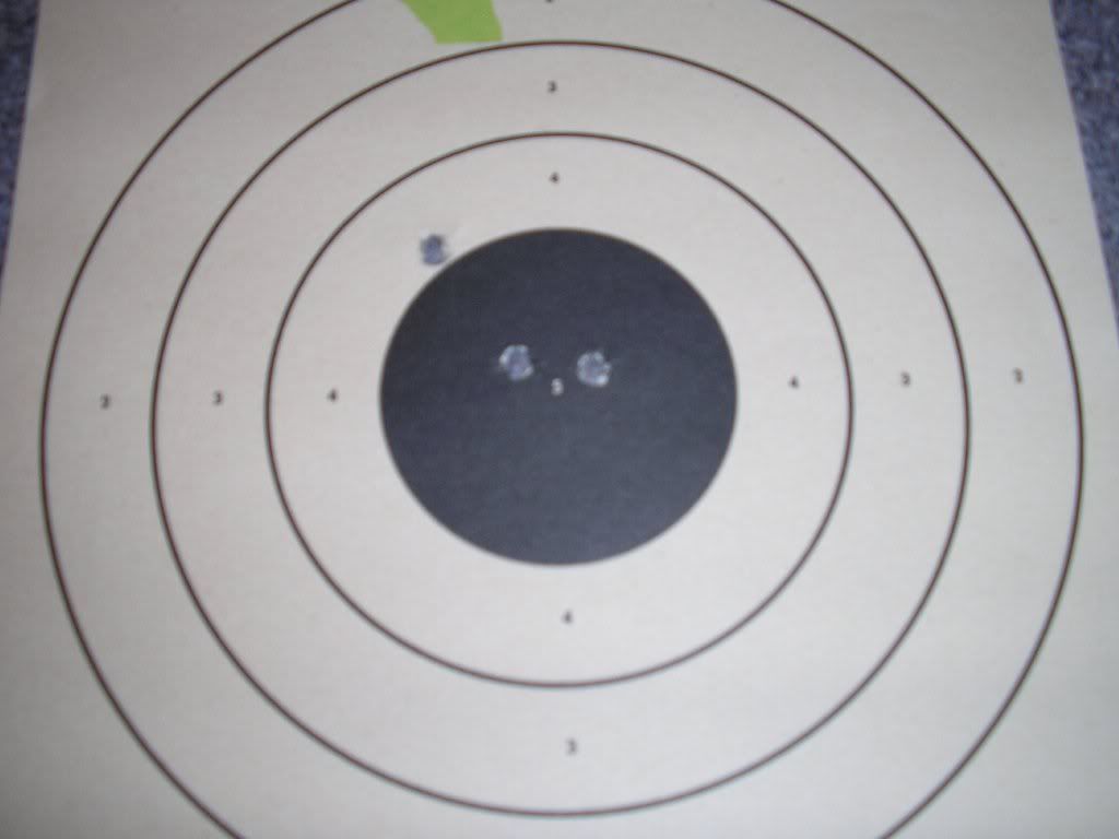

Today, I tried out 7 loads, all with IMR 4831. It is probably not the best powder for the application, but it is the powder that I have the most of and I am trying to use it up before getting something better. With the Lee C-309-180R mould I had previously cast a bunch or pure lead bullets. Today, I ran loads from 26 grains through 39 grains. At 39 grains, The projectile was sitting right on the powder when seated. I also shot 3 commercially cast 165 grain .309 bullets which have a BH number of 25. All bullets today were sized down to .304 with dish soap as lube, were washed off and then patched. In all loads except 1, the paper used was lined notebook paper. I did buy some onion skin paper and gave two wraps of that a try. Using the onion skin, the dried patched bullet measured .31284. (Hmmm, a potential paper bullet for the 7.62 X 54R?) I will try the onion skin again later with another wrap, or I will try patching a .309 with onion skin and then sizing it down to .314 using my favorite paste floor wax was as a lube. As expected, the undersized onion skin bullets performed very poorly in my Ruger. Two rounds missed the target completely.
One thing I discovered today, is that the barrel has to be "seasoned" with a couple of paper patched rounds before getting decent groups. If I wiped out the bore, my groups tripled in size. I have no idea why. As the 4831 was leaving unburned powder kernels in the barrel, I satisfied myself with shaking out the loose kernels and kept shooting. Once the barrel was prepared, I averaged 1.25" to 1.5" between the furthest bullets. These results were with the majority of loads at 50 meters, using 180 and 165 grn bullets pp'd with lined notebook paper. I am not a great marksman, so this is close to the results I get with commercial jacketed. Bullets ranged in hardness from pure lead (BHN 5) to BHN 25 (commercial cast). I think, I am going to stick with bullets in the BHN 8-12 range in future as they seem to work well at the mid range loads for the .303 and still give good expansion for hunting.
Here are some pics from today. I forgot to take a photo of all of the confetti in front of the shooting bench.
