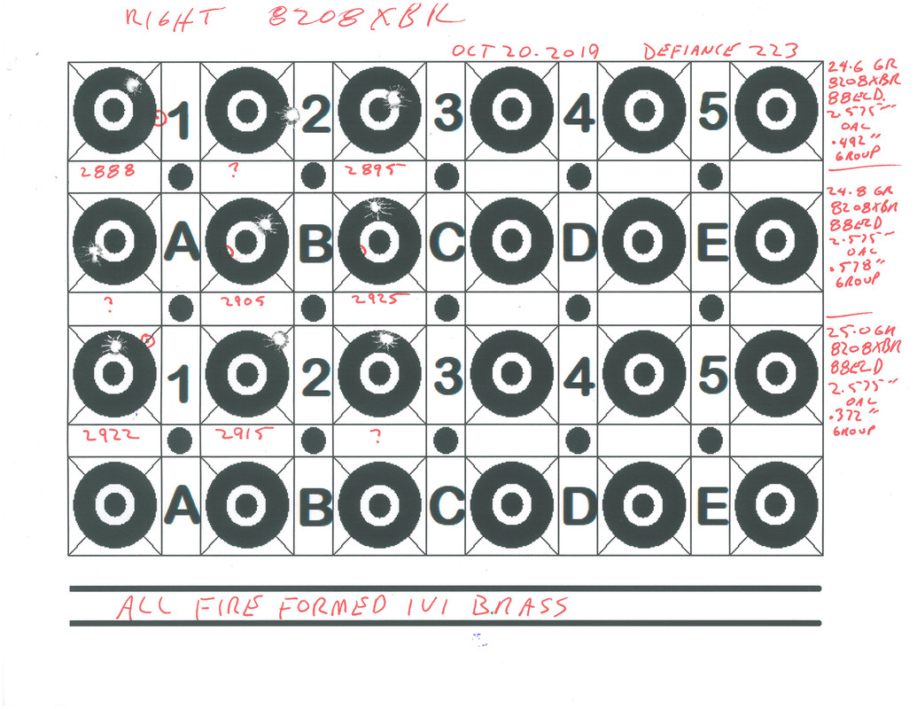

I've been doing this for load development and group evaluation for years. I like to associate which shot went where relative to the muzzle velocity. POI usually shifts when MV changes so it helps to know at what speed bullets go it the same place, and just as importantly, at what speed they string. I figure this technique more accurately identifies barrel harmonic nodes, and I gravitate to loads at one end or the other of that stringing direction.
