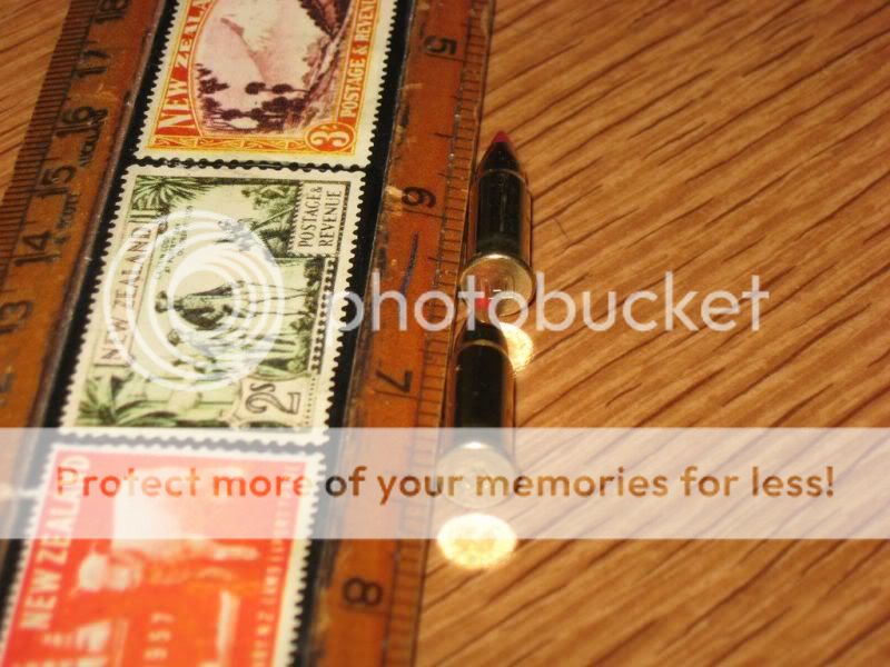

Here's a pic that kinda shows how they'd line up. There would be some extra clearance in the mag tube that would allow the point to move a bit closer to the rim, but it would have to be pretty sloppy for it to get all the way out to the primer area.
Between the extremely low recoil forces and the low probability of the point getting to the outside edge, I'd say you're good to go.

The rimfire cases are safe. The points line up with the centre. Besides how much recoil do you expect from a 17m2? Or are you planning on using the but to hammer nails? ;)Even then......
