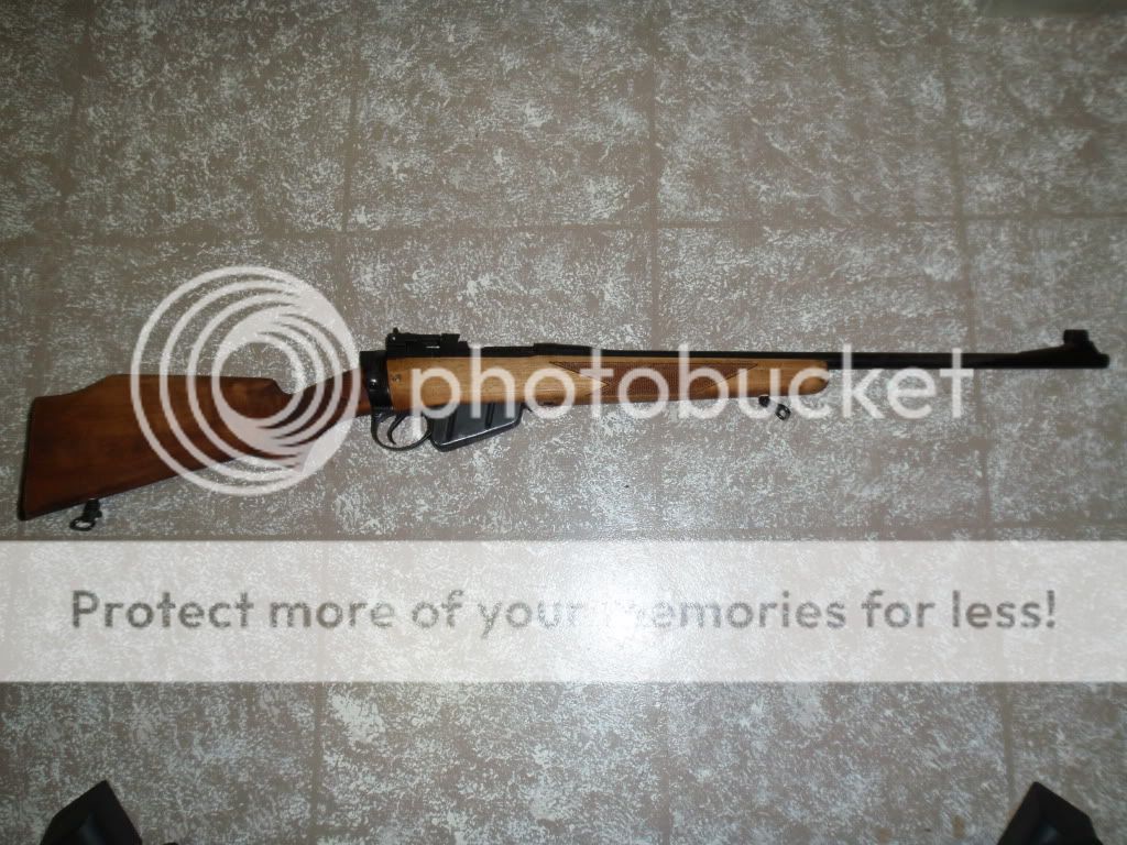

Just recieved a PH Sporter .303 minty bore with knob adjustable peep rear sight.The only downside is the stock was redone at some point.What would be best to get a dark walnut finish as this is stripped beech with checkering?Oh and a #0 bolt head to boot!..........Harold
Use a chemical stripper and remove the old finish. Stain with a good quality walnut stain. Refinish with whatever you choose (polyurethane, oil, etc).
How many coats of stain as this is beech and usually hard to stain evenly?Not sure if I should try oil or polyurethane?Does one steel wool between coats? The Swedish mausers never really took to staining worth a darn..............Harold
The stock is stamped SILE behind the butt plate.I know they did stocks for PH in Italy.Don't know for sure what wood they used?Working on posting pics just got back from replenishing our bear baits and it's snowing sideways here...........Harold

As you can see it needs a new finish and if you don't object give me a quick tutorial on oil finishing as well.......Thanx Harold

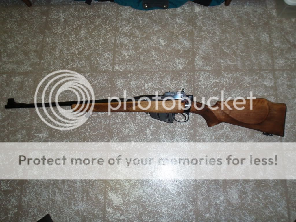

The wood's coming along nicely ,must be walnut on the 3rd hand rubbed coat.......................can't find the original maker as PH and England is stamped all over as well as 1944 Oh well 0 bolt head and mint 5 groove barrel.Bluing barrel next as it's rather splotchy.Any recommendations brand creme or what?........Harold
