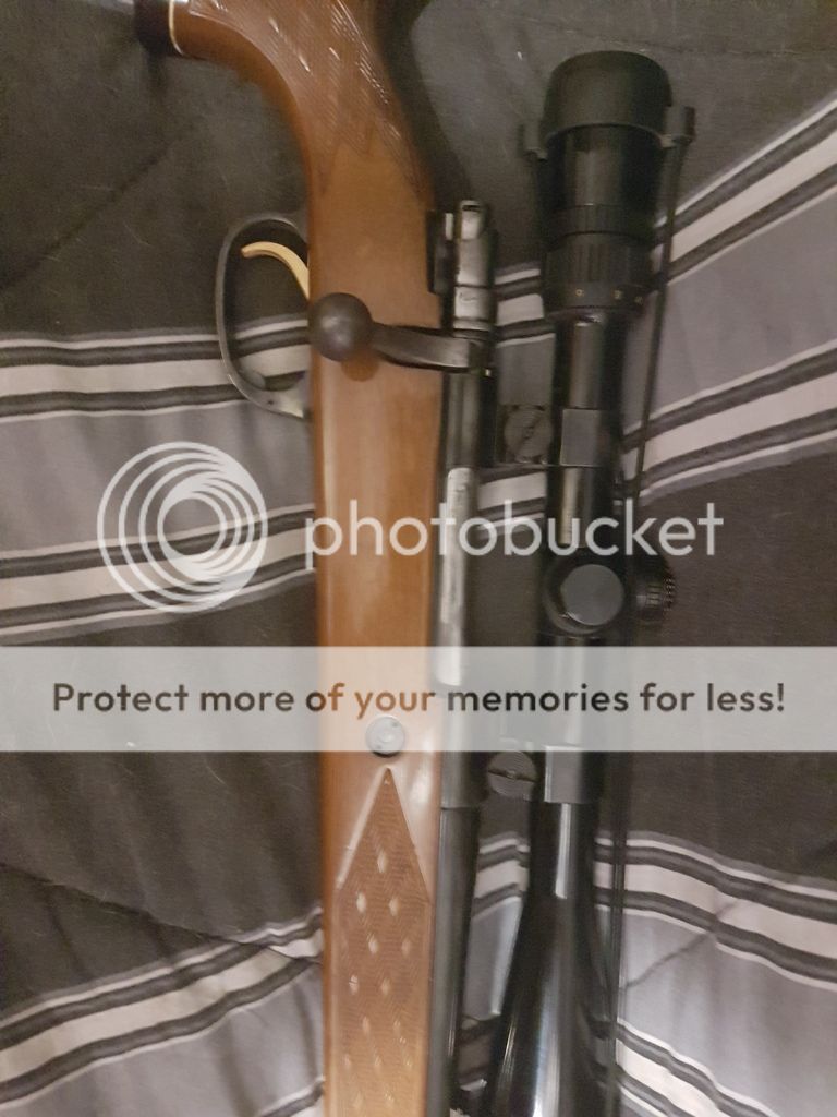

I have an old Parker hale 1200C in 7mmRM and it's an excellent rifle. I would like to put a boyds stock on it, but there were a few diffefent variations of this rifle over the years.
Can anyone tell me if I can get a boyds stock for it and which model of rifle i should select when ordering so it fits.
Cheers
I have the same rifle and my original stock is in great shape so far. Your picture does not work, photobucket gave up the ghost months ago.
Ha, ya I have not been on here much lately just noticed that.
Guess I need to find another hosting site.
My biggest concern would be that my rifle is mag fed and would like to still use the factory bottom metal,
Is this going to cause me a lot of extra work or should it all drop in with some minor fitting?
They specifically have one for a 1200, you can always contact them and see if they are designed to fit the bottom metal of the 1200c.
I have fit stocks to 2 parker hales, both of them fit a little differently around the action, probably a product of the 98 action, these are not the side safety guns.
Expect some fitting required but contact them to see.
I fitted one for my brother in-law. It was detachable magazine. Need a little bit of fitting, its not that bad of a job.
His stock was a thumbhole model.
