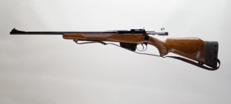

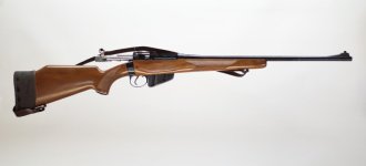

I've got 3, I'll try and take a picture of them when I get home, the nicest sporters IMO
Hello, I am genuinely interested in nice Parker Hale Lee Enfields that have been converted into hunting rifles. It doesn't matter to me if it's a SMLE or a No 4 I want to see some pics of them. I was wondering what rifles were available here in Canada? How were they ordered, through a local gun shop or magazine order. What were the different grades available? Thanks!
There were four grades of each No. 1 and No. 4 that Parker Hale made. Highest grade was called "Custom", then "Supreme", then "De Luxe", then "Standard" - I am not sure where the cut-off for "new" barrel was - the top grade had a "new" barrel, the lowest grade had a military barrel.
That might be an aftermarket put together - the 10 round mag was not with the top grade - that would have had a 5 round magazine. The picture is showing a rounded pistol grip cap with white line spacer - the top grade had a squarish grip cap from Parker Hale pictured in Parker Hale Catalogue - but I think there were many aftermarket stock makers for Lee Enfield No. 1 and No. 4 - many sold parts - not just Parker Hale. PH had most of their sporter stocks made by SILE in Italy - I think there were a number of North American commercial sources as well. The metal might be stamped with Parker Hale logo (where your shooting hand thumb might reach), but that one may not be all Parker Hale original. I am going by pictures in Parker Hale No. 68 Catalogue - Custom No. 4 on page 23, Custom No. 1 on page 24, and Supreme No. 1, Deluxe No. 1 and Standard No. 1 on page 25. Only the bottom grade - Standard No. 1 - had the 10 round mag, although any surplus 10 round mag could be used in any grade.

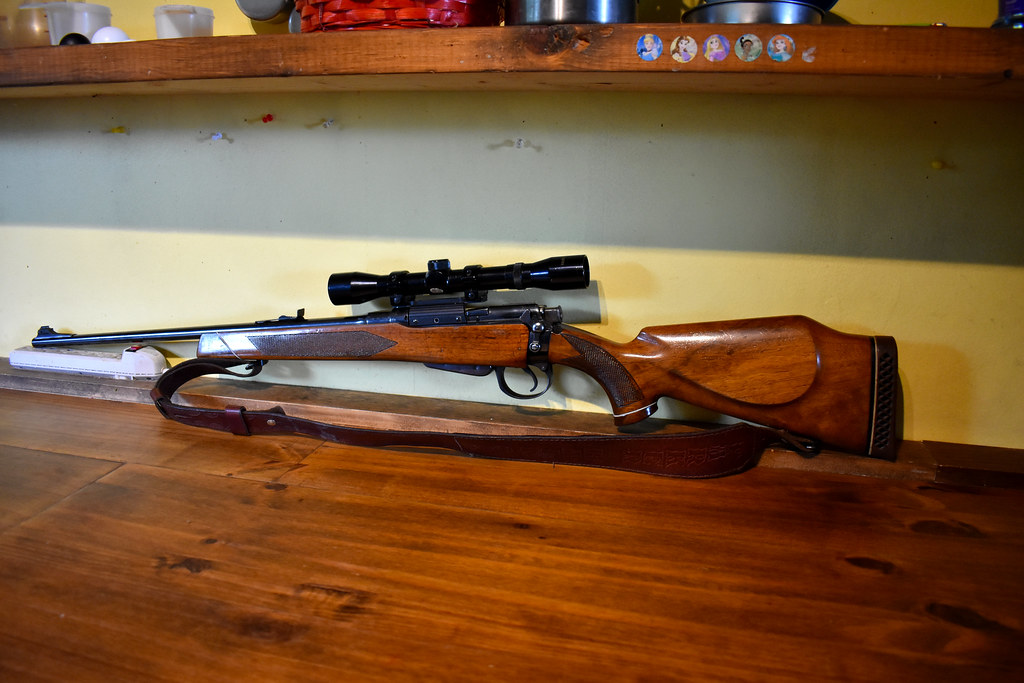

Any idea what model this would be?
It appears to me to be a Supreme No4, the charger bridge, micrometer sight and ears are intact. It would have come with a hood on the front sight. Is it stamped Parker Hale on the receiver as you note or on the barrel ahead of the Nock’s? The latter is where I remember them being stamped.
A Custom No4 with the optional D & T for the PH 29 side mount and RALS rings which are installed. Note the charger bridge and sight ears are milled off. The same receiver profile that one of the EAL models had.
It is Infact stamped "Parker Hale" on top of the receiver.
Your picture in Post #8 is showing the stamping on the barrel, not on the receiver - it is a relatively simple thing to unscrew a barrel from one receiver and into another receiver - without making a mark on either the barrel or the receiver. Some who have done so, may find evidence that has occurred - most will not notice. The actual Parker Hale receivers that were here have the letters "PH" stamped about where your right thumb would drop - behind the closed bolt handle, I think, or perhaps under it. So far as I am concerned, if those "PH" letters are not there, then Parker Hale never processed that receiver.
Internet says that Canadian based company Globeco, or possibly Adanac, sold Lee Enfield rifles with "Surrey" or "Sussex" marked barrels - also apparently an "Essex" stamped barrel - apparently those were all considered "low end" sporter conversions of former military made rifles - not "new" barrels, at the time. So, now-a-days, such a barrel could have been screwed onto about any Lee Enfield receiver - I am not sure what receivers those barrels were on, when originally sold.

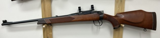

here is my custom no1, even has the PH sling. this is the first rifle I ever bought. It has the PH side mount and rings installed.
I think it's the custom no1, I find the no1 receiver nicer then the blocky no4 receivers. But the "custom" line from PH is the top of the PH line up.
