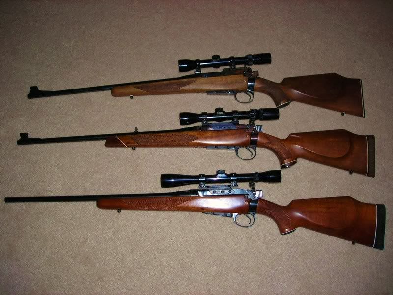

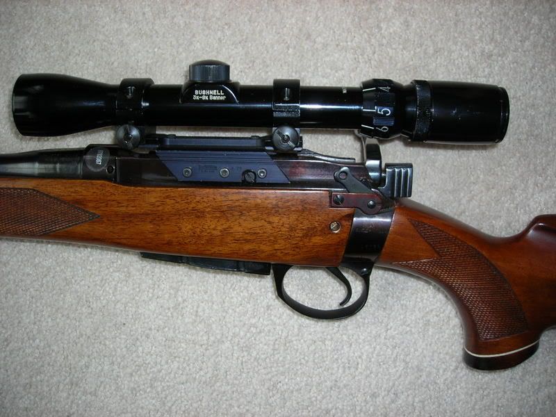

:)You have got yourself a nice (and hard to find) Parker hale conversion called a custom no.4 The action on it was machined specifically to allow for the parker hale side mount scope base called a A29. You will notice 3 holes drilled and tapped in the side of the reciever, the A29 will bolt right on with 3- 6/40x3/8" cap screws.Dont let anyone drill any more holes in it! If you put a post on the EE in the parts and bits sec someone will have one they will sell you. You will then need to get yourself a set PH 'A' series low rings.RALS3's will work perfect. I have the same gun with the mount system I have described , it is a sweet little 303 and in my opinion is the nicest enfield sporter conversion ever done. Enjoy it.
