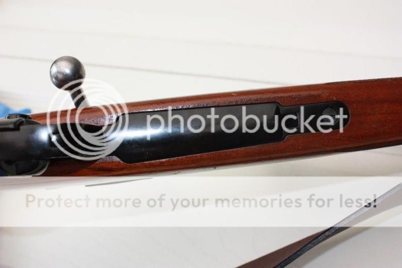

Not a removable magazine, just a swing out floor plate.

Here is the floor plate of this rifle

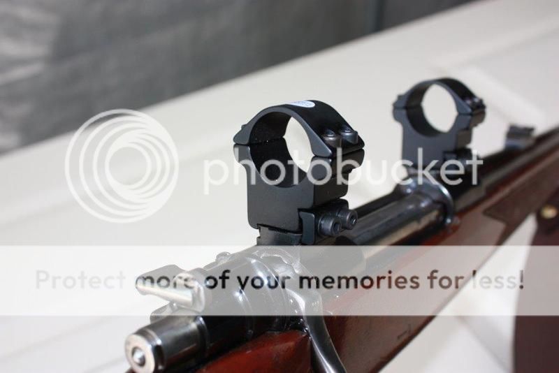

Here is the action

If there is a wing safety on the bolt plug, it is an earlier version; later ones had a side safety incorporated with the trigger mechanism. If the safety is on the bolt, you don't want a stock cut for the side safety. 1100/1200, more about finish than different designs.

As you can see from the pics this one has a wing safety.
