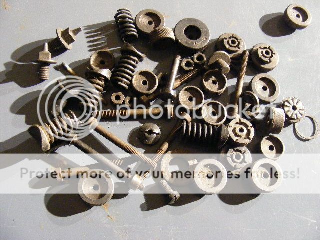

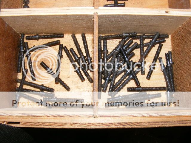

I think I have a baggy of parts for those sights. I had to replace that screw myself a few months back when someone broke the knob off. The only thing I found was that all (except one) of the replacement shafts had a larger thread on the knob end. Not sure if you were supposed to upgrade the knobs by drilling through and tapping them larger, or if there were different size knobs for them.
I'll take a photo of some of the parts I have for them. They were part of a large purchase of parts I bought from the estate of a retired weapons tech/DCRA shooter.
Here are photos of the few parts that I have. There are a few bits mixed in there that may not be for the target sights, but until I disassemble a sight completely, I won't know.
As I mentioned above, the threaded portion is too large for the knobs. Does anyone have an idea what they might be meant for, or were the threads recognized as a weak-point so a larger diameter was retrofitted? It would require the drilling and re-tapping of the knobs.
