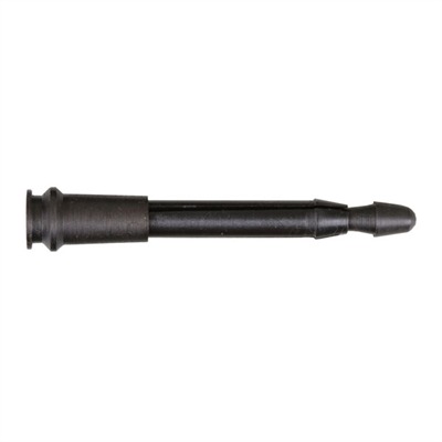

If a bore brush pulled from muzzle to breech doesn't work, you need a tool called a broken shell extractor. Brownells sells them.

If you're not in a big hurry, the broken shell extractor is the gold standard
You'll also have it if it ever happens again. I have one for each bottleneck cartridge I reload for.
Haven't needed them...yet
.30-06 version stock at Brownells.
ht tp://www.brownells.com/gunsmith-tools-supplies/handgun-tools/stuck-case-removers/broken-shell-extractors-prod24626.aspx
