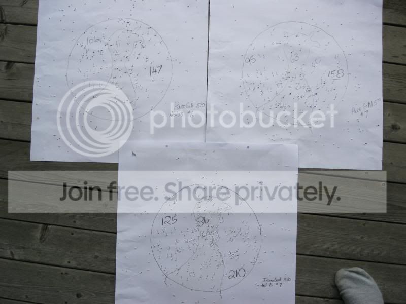

Patterning Ok now what pattern makes more sence ?
Adrian J Hare
5   0   0
I did some testing today as I'm heading off to the US in a bit and as they can shoot #7 turkey loads I thought I would try testing some.
The first target in the top left is what I have to shoot here.
What do you think ? the point of POI is not the same but every load shoots different....
Have you tested your loads for penetration? In my experience there is a HUGE difference in the penetrating ability of a #6 pellet vs #7-1/2's in lead. shooting at 3/8" spruce plywood at 40 yds, 6's will sail right through, 7-1/2's will stop in the top or at most middle ply. I would not use anything smaller than 6 myself. And the #6 pattern looks plenty dense enough.
To those concerned about penetration, this is denser than lead shot. Should penetrate like #6 lead. That being said, any of those shots would result in a dead turkey.
sorry mac not even close bud ...
My friend us old goose hunters were reloading this stuff long before they tried it in turkey rounds was just too too expensive for me at $25 plus a pound . Once I worked out some high speed steel duplex loads they were just as good. Dead is dead

50% W, 35% Ni, 15% Fe. Slightly irregular in size and shape, very dense – 10% heavier than lead, about as hard as or harder than steel. Corrosion resistant. Can use slightly smaller sizes than you would with lead. Patterns extremely tightly - hard to do less than 70% with any choke. Any 12 ga. choke tighter than 0.665” will open the pattern. A standard Full choke, at about 0.691”, will pattern over 85%.
From ballastic products
Hevi-Shot is a non-toxic alternative to steel with density similar to that of lead shot. This pellet produces impressive long-range patterns and down-range lethality.
Hevi-Shot is comprised of tungsten alloy (tungsten is an element which is harder than steel/iron), nickel, and iron. Hevi-Shot pellets are very hard and they must be contained within a special non-toxic shotcup.
When selecting Hevi-Shot pellet size, the general rule is to use the same or one size smaller than you would have with lead shot or two to three sizes smaller than steel shot. With that said, this type of generalization cannot replace actual field testing on your part.

Doesn't really matter your no. 7 hevi shot or No. 6 lead will kill just fine. Hope you land a nice big tom
