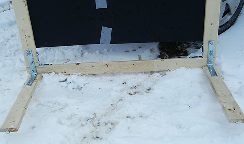

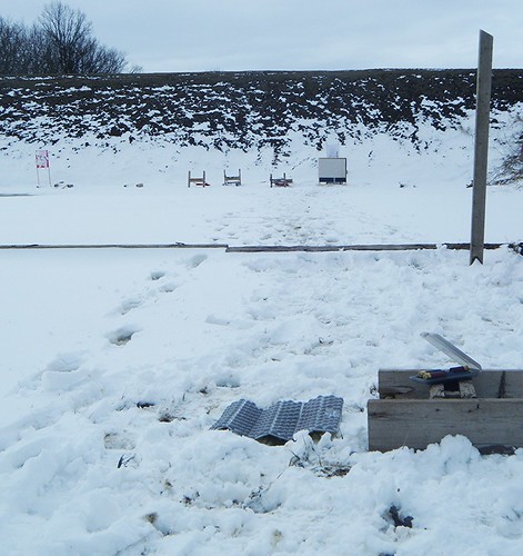

A range with a 20-30-40 and even more distance to shoot to see what kind of patterns you may come up with.

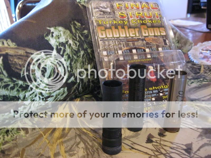

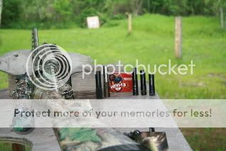

Trying out different chokes is the most expencive part and for a good turkey choke that limits the money spent for the pattern your after your going to spend that $75-100 dollar range. This picture only shows half the chokes I have tested in this gun.

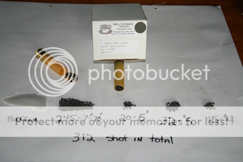

I have tested every shell brand on the market and narrowed it down to only a couple different brands. I even got to the point that I also found differences in the same shell brand under different lot numbers.
I have also cut open some of the top shooting ammo to just see what is headed down to the target that produces some of the best patterns that we may see on the net. This example is a shell brand out of the States that allow #7 shot and some places there do allow #7 shot for turkey hunting. Here in Ontario we are stuck with a 4-5-6 shot and to gather patterns like some of the shooters in the USA are getting are not going to be close, so dont pound your head because your not comparing to these shot dencity patterns from down south.

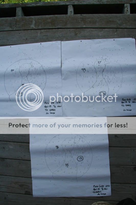

My turkey gun is just that and I have taken confident shots that has dropped the jaws on partners that could not believe that a 20 gauge would be capable of. The targets that I show are of only 40 yards and are using only #6 shot. I could very well beat them all if I shot a #7 turkey load easy, but there is no scence in that as we here in Ontarioi can only use the smallest of #6.

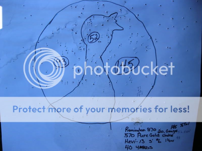

A friends Remington pattern
Patterns that can produce will make success that much easier in the turkey woods
