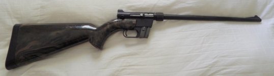

I have both the Armalite (ca 1962 per SN) and the Henry and have found both reliable and 'acceptably accurate' for what they are. When I got the Armalite in '21, I found 'online advice' on action assy indicating the 'Hammer Spring' should be 'crossed' over the trigger pivot. Experimenting I found that is incorrect in that it 'functions erratically' like that, but w/o crossing is more reliable and the trigger is Lighter! The Armalite does NOT cycle semi 'all the time' with SV but is 'deadly' with Rem Golden HV. I cut ONE coil off Each Recoil Spring attempting to improve cycling SV - Not Helpful. The Henry will cycle SV as well as HV. I just got it this Spring. NO Feed problems with either rifle Except for the Armalite SV-thing.
"Wrong way" for Hammer Spring, b4 I found out !
