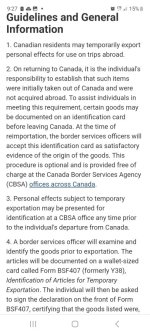

Where do I look to find matches? And what do I need beyond what I normally take to a match in Canada, I know about the 6NIA form for border purposes - is there anything else?

Canadian residents (aliens) cannot obtain a SBR Cert. You cannot get a Form 6 for an SBR aka a carbine with a barrel length less than 16". Americans can apply for an SBR cert or stamp if you prefer. I believe the cost is $200 and a friend of mine says it takes about 8 months to process.

I was looking at going to Washington State for some matches but with all the rules it doesn't seem like it's worth the trouble.
Not only do you have to worry about federal law but Washington State also has an assault weapons ban that prevents the importation of "assault weapons" -

Basically, if it's semi-automatic and takes detachable box magazines with any of those features it's banned. If it's got a pistol grip, adjustable stock, flash hider or even a threaded barrel? Banned. Mlok hand guard? Banned.

Yup, that is my understanding hence why most Americans run 16" guns.
As a Canadian you are forced to buy a 16"+ PCC if you want to compete in the States.
