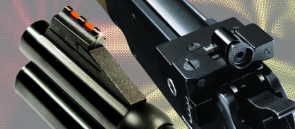

Williams FP sight with fire sight front

I'll go with David on this one. I put a Williams receiver sight on my .307 a week after I got it back in '95. I've never budged from my 150 gr. handloads and it's never budged from its zero.
I would have to side with Cannuck and Dorm here.
Once I changed out the original factory rear sight, for the Williams FP, on a
30-30 Winchester Carbine. The new "Fire site," I also mounted up front, is about a third smaller in size.
Cannuck has it 100%, right there, in his post.
In 2005, I took out a deer at a long 260 yards.

Therefore, a Williams Foolproof (FP) receiver rear peep sight (Top Eject model) sight will fit it.
No drilling and tapping required.

Your Williams looks much like the Lyman that I put on my 94. Is the aperature a little right of center? This is my first try with a peep and after sighting in at 100 yards with very consistent groups, I have noticed that the aperature is visually right of center. This does not make sence to me as the front sight seems centered, but the aperature is well to the right of the bore.
Ooops! wrong pic selected, but question still the same:redface:
