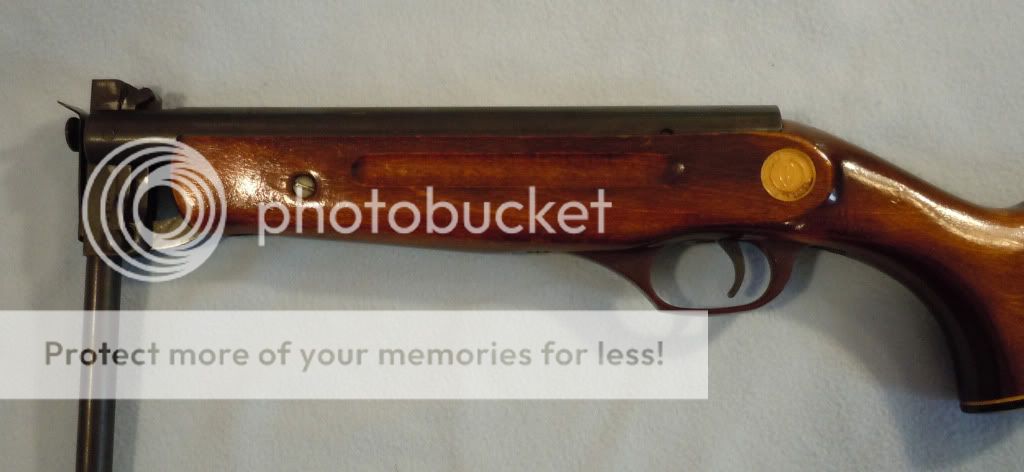

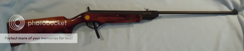

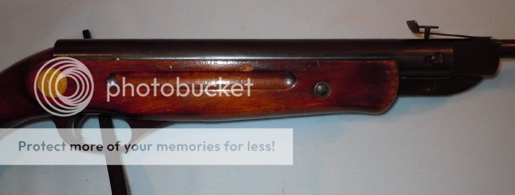

First question: what is this?
The yellow circle seal thing says Made in the USSR.
It took about 5 shots to get one pellet through the barrel. My second question: is it possible to tear this thing apart and repair it back to full strength?
Thanks!
It is an inexpesive Soviet-made pellet rifle. It should state the model on the top of the action. I'm guessing it is some version of an IZH-thirty something (it could be IZH-38). Is the barrel clear? rusty? gummed up with oil? If you can get the bolt undone, you can take it apart. I don't think they were ever very powerful. New versions are not very expensive. I'd be surprised if there ever were parts made for these guns. You may have to improvise.
There is no print on the rifle except for a serial number and the USSR stamp. This stamp also says (upside down T)J - 22.
Bore is shiny. No rust on any metal. It feels in good working order except for the fact that it doesn't push the pellet through.

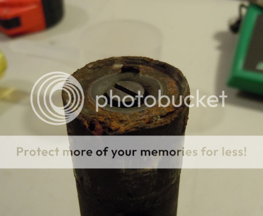

These things had a leather or felt "wad" in front of the piston that worked as a gas sceal. If that sceal is degraded the gun won't generate any significant pressure.
Unscrew the stock, there should be a cross pin at the back of the action once you take that pin out the spring, piston, and sceal will come out.

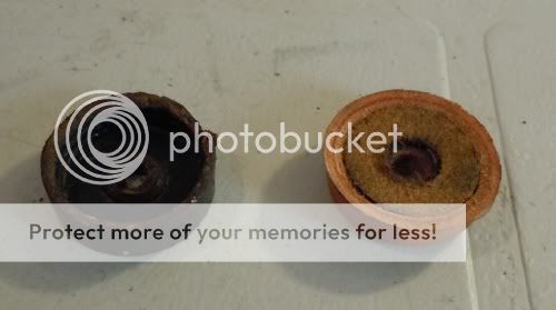

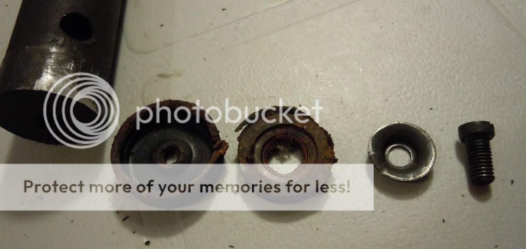

Here is a picture of the seal. It is currently a little crumbly, although it appeared to be intact along the outside edge. Any reason why it is in 2 pieces?
Would it be practical to find something to replace this with? Also, everything is coated in black dirty grease. If I cleaned everything off, should I lubricate any parts or just run it dry (assuming I can replace the seal on the end of the piston).

Actually the seals are leather, and are in two pieces to keep from deforming.
It is a Baikal airgun, made in the USSR.

Just from my experience...the tube should be well cleaned and absolutely shiny smooth. The two opposing leather seals can be carefully home manufactured, if you have the knack and some simple tools. The type or finish to the leather has to be rather soft and smooth on the tube bore face. The middle washer in your pic is absolutely shot, and both should look like the left one - cupped, and are attached with the screw & metal washer, one looking up and the other down. Use the left leather seal to guage leather thickness. Leather seals must be kept well lubricated with light oil that contains no additives that would deteriorate the leather. Synthetic seals may or may not require a lubricant - be aware of that. I'd stay with leather, as synthetic wasn't intended for this gun anyway. That all looks pretty dirty, but you should be able to clean everything up and have it working fine again. Also check the condition of the breech seal for leaking and barrel cleanliness.

You can make your own leather seals pretty easy. A bench vise, some sockets, and a block of wood. Some drills to drill holes about the size of the OD of the seal... Info is posted about the web if you go looking. Basics is to wet the leather, then press it into a hole with an appropriate round object (socket), to form the cup. You then cut it carefully, and go from there.

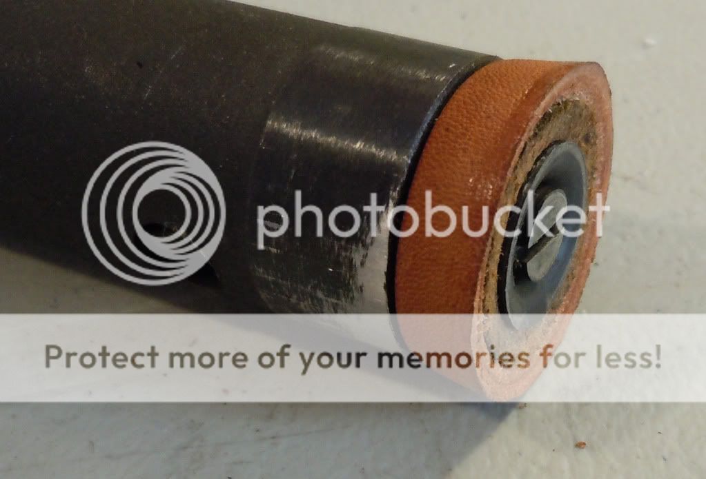

I found a 1 inch replacement piston seal at jpairguns, so I'm going with that for now. Trev is correct about the breech seal being hard as a rock. I haven't tissue tested the breech seal as the gun is in pieces right now. It'll be tricky getting it out. I think I will replace the seals first and see how it performs before I go for the spring replacement.

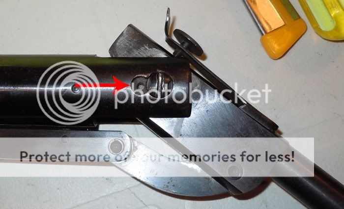

Does anyone know if / where I can get a replacement for this missing retaining screw:
Thanks
I think you are on your own here, you could try a switch plate receptacle bolt for the thread size.
Shimming the receiver forks is generally a good idea if the utmost accuracy is expected.
A beer can makes good shims, try one side, if it still feels sloppy, do both. KD
Update: I replaced both seals. I made a rubber one for the breech seal from a rubber washer. It shoots a little better now, but pellets still remain in the bore 75% of the time (but they make it further down the bore!). I have no breech leak anymore. Looks like I'll have to get a new spring.
