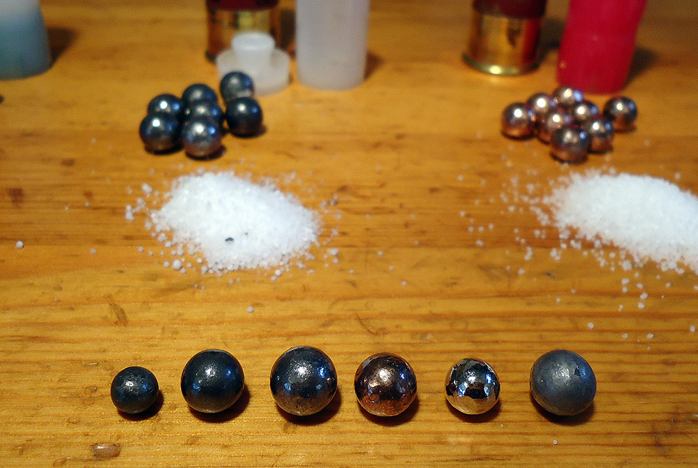

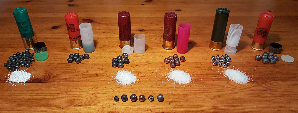

From left to right:
  • Reminton Express #4 Buckshot;
  • Hornady Superformance 12 ga 2 3/4 00 Buck;
  • Federal Power-Shok 12ga 2 3/4", 000 Buck;
  • Federal Vital-Shok 12ga 2 3/4", 00 Buck;
  • My hand loaded #1 buckshot load; (I did not test this one)
  • Sellier & Bellot - 12GA, 2-3/4", Sport 00 Buck

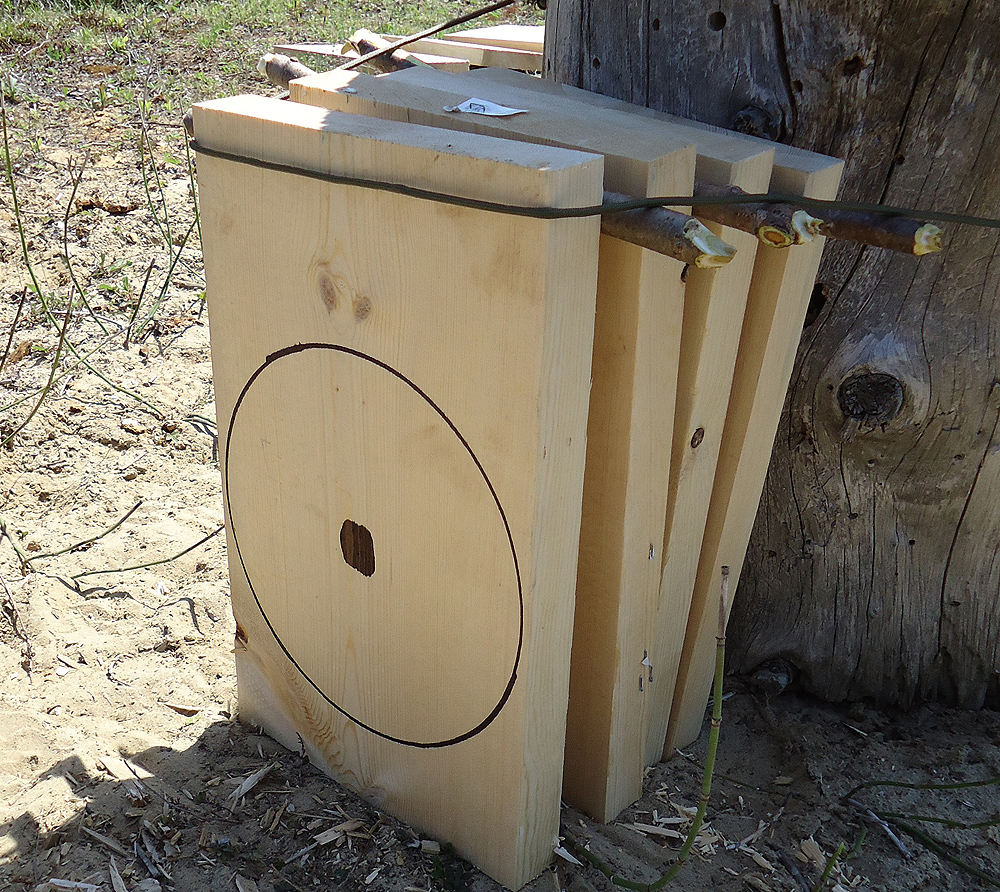

The Setup
I had four boards of spruce 1.5 inches thick stacked behind each other, and with a 9 inch circle as my target. The gun was a 870 Police 12ga with rifle sights and a fixed improved cylinder choke. All shots were fired from 20 meters.

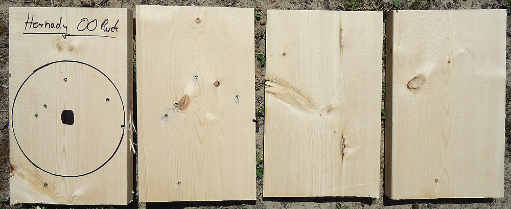

  • Model: H86246
  • Muzzle Velocity: 1600 fps
  • Pellets: 8
  • Wad: Flight-control Wad
  • Buffer: none
  • Hits within a 9” circle: 5
  • Penetration: did not penetrate 2 boards (the second board stopped all pellets)
  • Note: I had expected more from this load because of the high velocity of 1600 fps

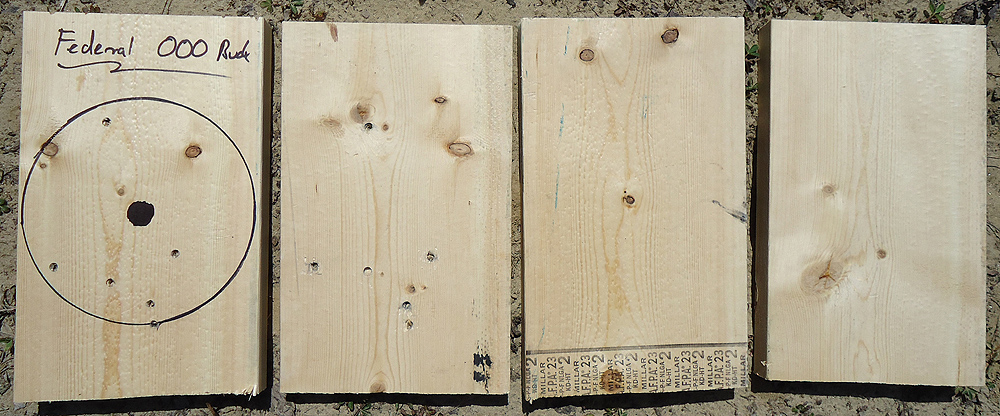

  • Model: F127000
  • Muzzle Velocity: 1325 fps
  • Pellets: 8
  • Buffer: yes

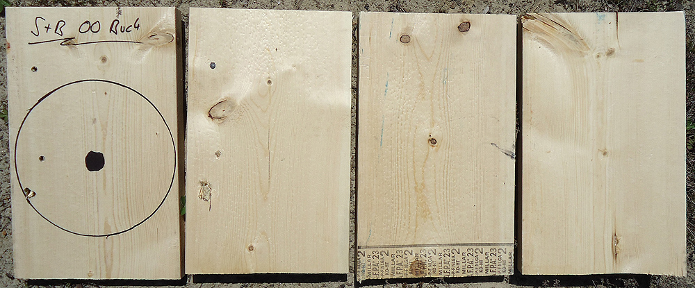

  • Model:
  • Muzzle Velocity: 1214 fps
  • Pellets: 9
  • Wad: none
  • Buffer: none
  • Hits within a 9” circle: 3
  • Note: This load produced the worst pattern.
