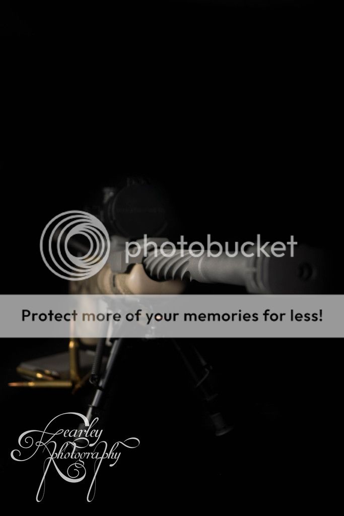

Now the spiral opposing the torque imposed by the spin of the bullet... I think the theory hold merit on a theoretical level (for the very same reason of rigidity)... But you'd actually have to have the fluting spiral in the same direction of the rifling. I'll post a picture of my rifle as a visual aid to try to walk through the logic. (And because it's damn ###y).
So, the bullet comes out with a right hand spin. Meaning the top of the bullet is moving to the right as you look towards the target. So, looking at the muzzle, (as in the beautiful picture), it's turning counter-clockwise. To induce that spin, there is an equal and opposite force exerted on the barrel. Therefore, looking at the barrel it would be like holding the muzzle and twisting it clockwise. Thus making the spirals "tighter". Now to complete the thought experiment, imagine removing all the material which doesn't have the greatest "second moment of area" (I)... all the stuff with the least radius. You would be left with a spiral of metal like a spring. And it would be "easy" to turn clockwise, and "hard" to turn counter-clockwise.
For those of you still following.... the score is. Yes, more rigid to bending. Not more rigid to torsion... in fact, maybe less rigid.
But, diminishing returns here. Less rigid to torsion means that as the bullet fires there is a tendency for the rifling the "straighten out"... so your 1 in 10 twist might become 1 in 10.00000000001 (I just typed a lot of zeroes and didn't do the actual calculation, it's small). How soft your bullet jacket is actually plays a role, and probably has a greater affect on consistency than the barrel would anyways since bullet jacket material may be slightly different for each bullet.
Conclusion: The spiral aspect of the barrel fluting having anything to do with consistency is a stretch... Looking damn fine, which is half the battle after all... well... here's the picture.
