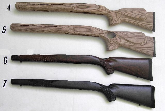

I think the lock time on this action is faster than the military 98 I mesured both and it is a shorter distance that the sear has to go about 0.100 thou also I already have to many 700's I am not that fond of them I think they are overrated plus I don't like the extraction system and having to line up the recoil lug I actualy like the savage better.The stock I have is a fajen laminate with the vents aroud the barrel I will try and post some pics it looks like maybe a F class style stock not sure.

Try the thumbhole varaints or this one.
