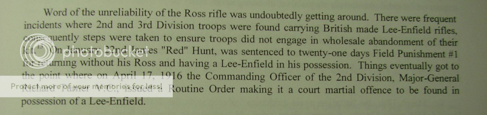

The debate concerning the Ross rifle continued.
Excerpt from the book shown above which begins to get into the politics regarding the Ross rifle.

It is possible that things weren`t sorted out properly because there actually were TWO problems, each feeding the other, so to speak. The Ross Rifle had no troubles at all when fed with British ammo which was TO SPEC. The chambering problem only arose when the rifles were fed ammo which was SO FAR out of spec that it was troublesome EVEN in the SMLE.
Now we come to ANOTHER problem. The body (receiver) of the SMLE is much smaller than that of the Mark III Ross. When the SMLE was Proofed, the charge actually EXPANDED the chamber of the rifle approximately .002. The REAMERS were made to Enfield spec, both for the Ross and for the SMLE, but the massive Ross action didn`t STRETCH when the Proof round was fired. This accounts for the extreme difficulty in removing an SMLE barrel; the new barrel screws on with finger-power, but it can take anywhere up to 400 ft-pounds of torque to break an old one free.... following which it turns out by finger-power.
But the ammunition problem was known at that time, no doubt at all.
The problem with the RIFLE was the small bolt-stop, which, when operated too exuberantly (or kicked) would pein itself against the left-rear locking-lug, deforming both the lug and the stop. When this problem was sussed out, the rifles were modded and new bolt-stops (at 30 cents apiece, mind you) were instaled. This stopped the peining of the locking-lugs. If a bolt-head were deformed, however, it could jam the rifle; I have replaced bolt-heads on rifles which were jammed up solid, following which they worked very well.
Apart from the ammunition, the RIFLE problems were very minor and would have been sorted out beore the War.... except that the Mark III never had a full-out troop trial. It was TOO NEW, the very first rifles being made only in 1912 and ony a few available for test in 1913. In 1914, the troops trained with the Mark II and then were haded brand-new Mark III rifles which were actually made while they were training!
IF they had had only ONE more year........
But they didn`t.
And the whole thing has turned to a matter of legend.
The ammunition problem is discussed thoroughly in one of the Appendices to the Official History, "The Canadian Expeditionary Force in the Great War", a massive set of books (about 40 volumes) published in the 1920s. There is a full set in the Library at the University of Manitoba, among others. The information as regards the ammunition problem, IIRC, is in the Appendix to Volume 38. THIS APPENDIX has been reprinted as a small book and is available currently for about $15.
