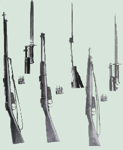

I thought so, It's just the hole in the bayonet is too high up and does not align with the barrel as shown by my first picture (as best as I could get it.) :/ Well I will leave it for now, but for it to actually fit I would have to cut about a 1/4" off so the hole on the bayonet aligns with the barrel.
Before you cut anything make sure the slot in the back of the bayonet fits over the boss on the rifle, these bayonets should fit without altering either the bayonet or rifle.
Yup the slot fits nice and snug, but the loop is still does not align with the barrel. I turned the bayonet to fit it on the barrel and the loop fits snug on the barrel. Weird, maybe I got a lemon?
That is weird, what is the measurement from the base (bottom) of the muzzle ring to the handle? My M91 Carcano bayonet comes out to .733". It does fit my M91 no problem.
From your photos it definitely looks to be a M91 Carcano bayonet (the rounded ball at the end of the cross guard tip is pretty distinctive). Let me know what the measurement is, it will help determine if your bayonet is off or your rifle is (or if it is some other sort of bayonet).
This is how my M41 looks with the bayonet on it:
Your barrel band almost looks loose on the top, that is likely your problem. Try putting some paper shims on the bottom between the barrel and the stock at the muzzle and it will likely fit properly.
