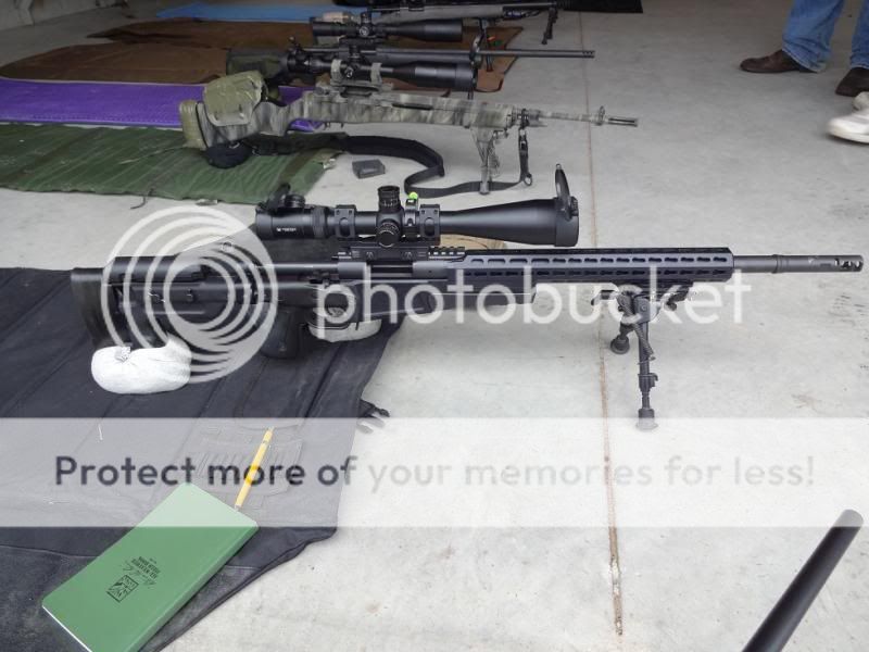

On rear bag/bunny: A rear bag or monopod is essential. From Hungry I Learned to sacrifice some of my daugher s fluffly friends and fill my future sock or bunny with dismembered plastic entrails from my daughters demised plush toys. Thanks Hungry as they are Light and won t absorb water. Also I had a wire stock so on opportunity and agony snaps, I started hooking my thumb into the actual wire stock n using the rest of balled fist on top of the rear bunny sock. But Having that thumb hooked into the rear stock allowed me to reposition quickly for quick snaspshot or followup. I was able to catch upon a missed snap a few times. I liked this a lot. I'm going to start trying to this from now on. It also allowed me to cheat a bit on snaps by raising fingers up or left to right, sort of like pool player 's left hand. not 100% stable but really fast on snaps when there is just not enough time.
