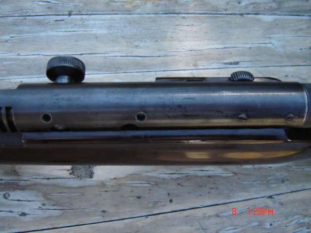

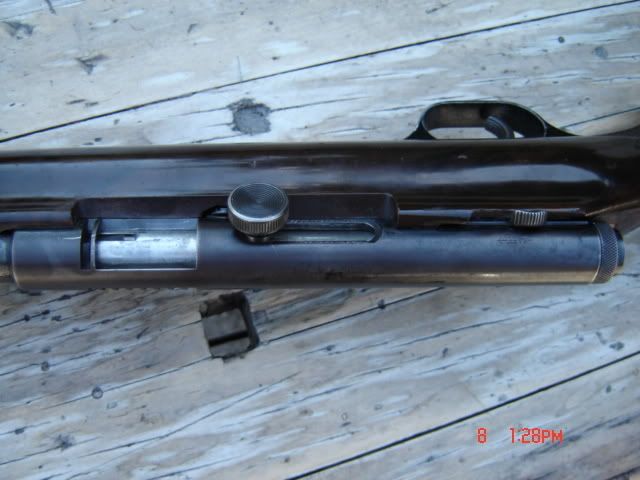

I can't seem to find a mount for this as I’m told it's like 50 years old. It has tappings as seen in the pics but I was told they are for a peep mount. Anyone mounted anything similar or can help me out with a custom mount info?

Well i found out that the rear holes were for a peep sight from the guys at rimfire.com and the fronts MAAAAAY be for a scope mount. I've called everywhere (ok 3 places) to ask about scope mounts and everyone tells me there is no info in their computers on a mount.

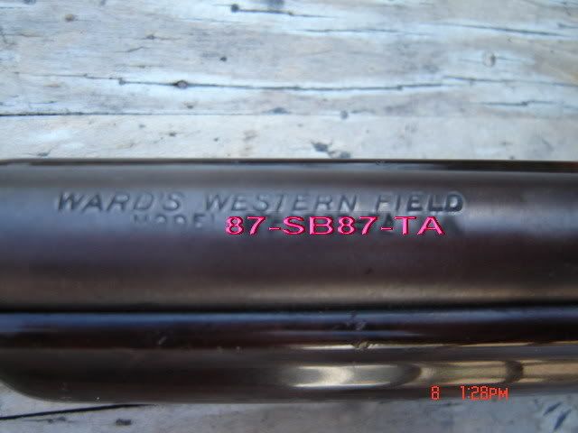

I think it is a Stevens, I guess an 87, obviously made for Monkey Ward. It could take a bit of searching, but a Weaver Type N mount will have been made for it. Now, most Type Ns take 3/4" scopes, so you may need to look for a vintage scope. This would be entirely in keeping for the rifle.
If you want to mount a 1" scope, a Weaver #2 sidemount base could be fitted. Don't know if the holes in the base would work, or not.
Or, the top of the receiver could be drilled and tapped for a modern base, and rings of your choice could be used.

You really know your stuff. I e-mailed weaver and this is the short response i got.
"""The Weaver Side Mount # 2 48402 along with the Side Mount Rings 49350."""
