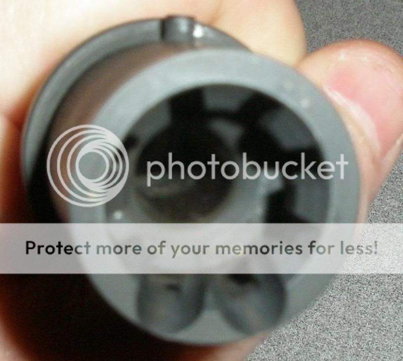

I was looking to buy a A3 Flattop Upper, With M4 Ramps.
So, I wanted to make sure this barrel had true M4 barrel extension.
It looks similar to the pic I found on ARF.com website, but I wanted to make sure.
Sorry for the bad quality photo
Thanks

Bascially you can't swap out the barrel extension. It is pinned in place when the gun is headspaced and the gas port is then drilled to line up with it. A new extension may not index properly with the now drilled gas port and then you're pretty much hooped.
FWIW: M4 extensions will not do a thing in a semi-auto, and it is questionably effective in full auto. I'd wait for the correct upper for your barrel. They're out there.
Good luck with it.
Cheers,
DT
No need to delete it, theres a good info pic there for some who want to know how the feed ramps look
