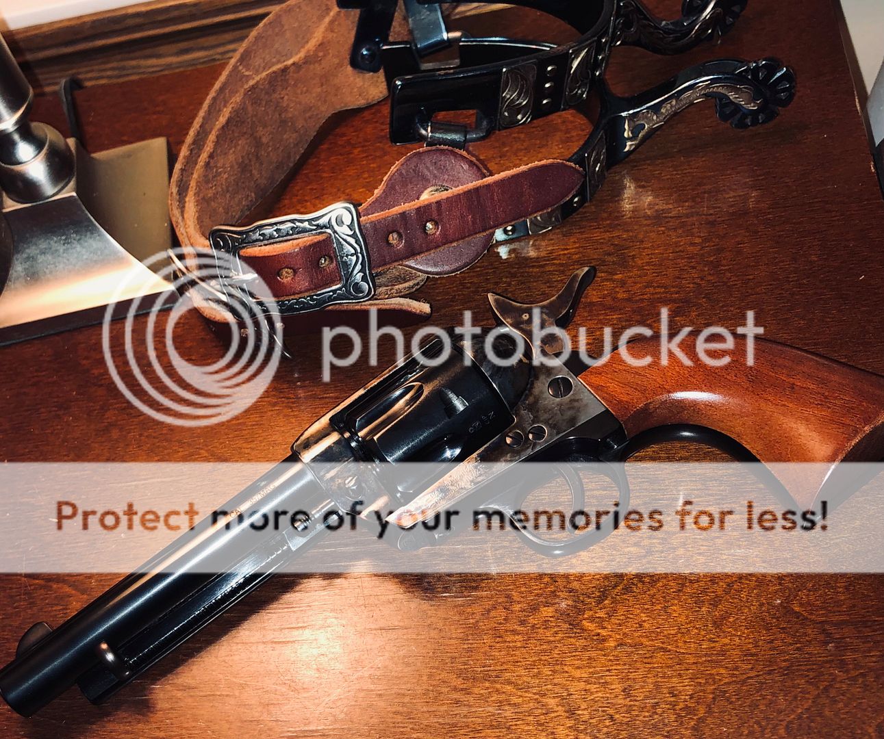

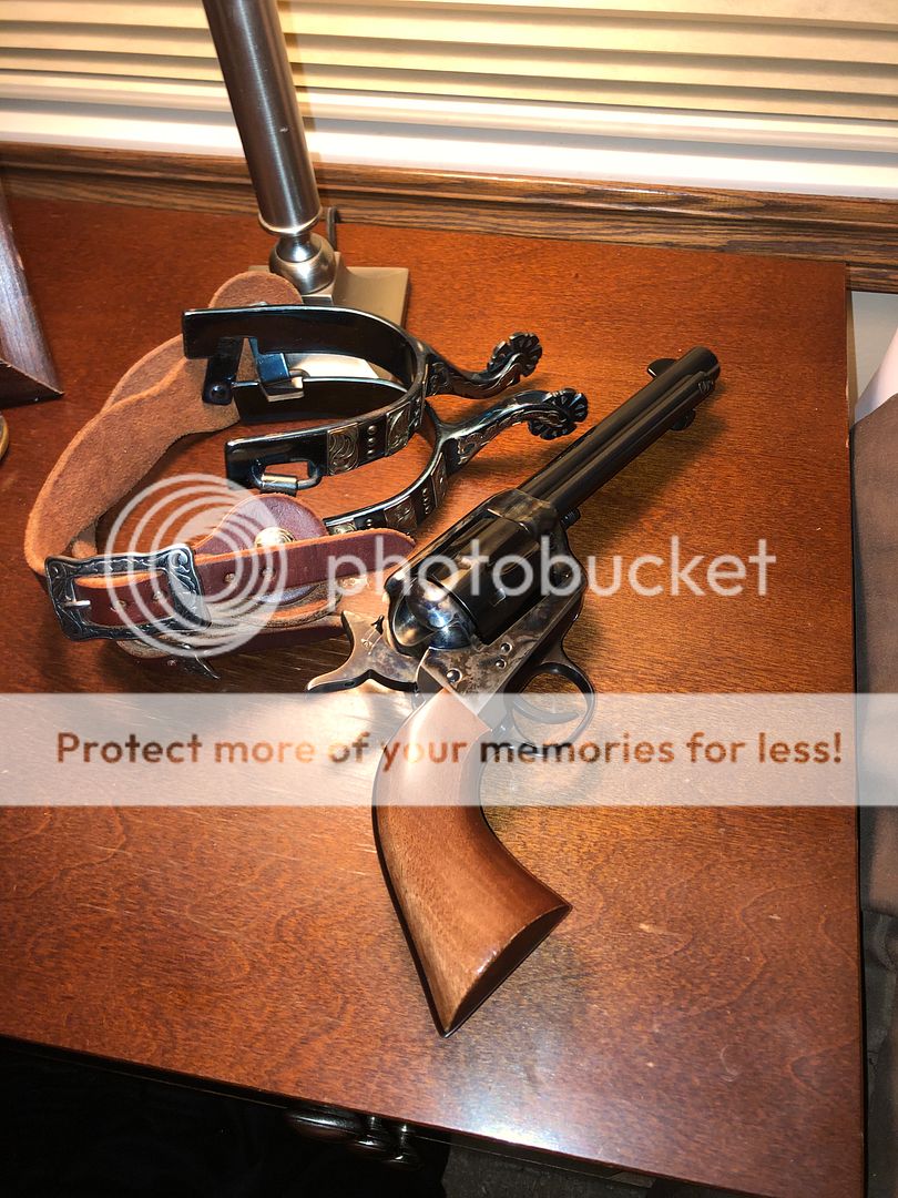

I've had a couple, just bought the one immediately below off EE. Will shoot it for the first time this week - it's a 357 mag 7.5" bbl. The one at the bottom I bought new in 45 colt 5.5" bbl. I also own a 45 Ruger NV and recently sold a Uberti Cattleman.
Anyway, really like Pietta's and think they compare well with the Uberti's in fit, finish, and accuracy. The Vaquero is in a class of it's own IMO.

KO: Pietta revolvers are about as close as any reproduction gets, to an original 1873 Colt. Very simple to work on and maintain. Fit, finish and function....all first rate. Timed perfectly. I own several(not this model though).
First thing I usually swap out on these revolvers, is the bolt-trigger return spring. The stock, two-legged leaf spring, though delivering a very crisp trigger break, is not as reliable as it could be. They have a nasty habit of breaking. Not the Pietta revolver's fault. The 19th century spring design is the culprit. Luckily, its an easy fix.
Should you choose to replace yours....an aftermarket wire replacement spring is the answer. Easy to install. Makes the revolvers very reliable, even under hard use. Site sponsor: Rusty Wood Trading, is a good place to look for one.
Though Pietta generally does a pretty good job of polishing the internal parts of their revolvers, I also like to reduce any potential friction spots, too. Includes polishing the hammer and trigger pivots. Sides of the bolt, hand and trigger. Hand slot. Camming lobe on hammer. Plus polishing out any spots(if any) where the hammer and frame make contact(small scratches appear on hammer). That`s about it.
I like the speed and crisp hammer drop delivered by the stock mainspring, so leave it in place. There are reduced tension springs available should you wish to replace yours, though.
The .357 is a good caliber choice for these revolvers. Versatile and works well with .38 Special, too. The front sights of mine have been filed and regulated to shoot point-of-aim with my competition loads. But not necessary, unless you choose to do something similar.
Not much else to add. Nicely balanced in your barrel length. Point and shoot very naturally. Overall, in my opinion, a lot of gun for the money.
Enjoy!
Al

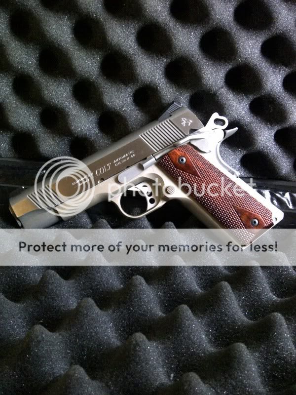

Thanks for the info guys! It’s nice to hear some opinions and see the pics. Initially I wanted to buy a Vaquero, still on my list for one one day. An actual original Colt is on the “someday, when the kids are on their own” list haha. I still have my Colt LW Commander, which is on the keep forever list, but I’m really in a single action phase now. Especially after seeing all yours, lots of different options! Haha.
Off topic but here’s my only Colt
