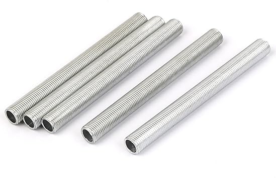

Nothing magic about pillar bedding tubes. A rough exterior improves the bond.
Had good luck with this
