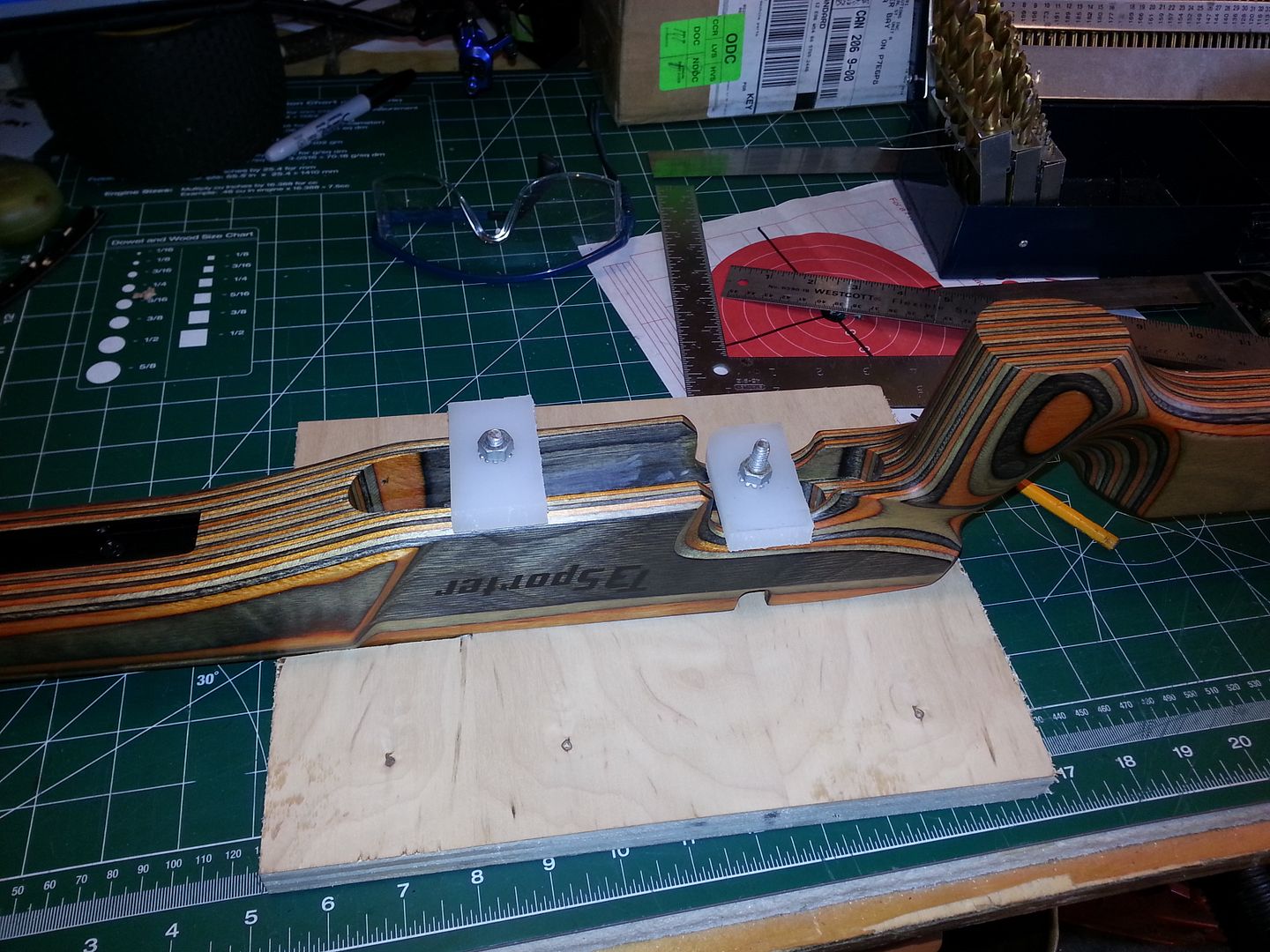

I built a jig to hold the stock and then used a drill press to drill out the action screw holes. Then used Devcon 10110 to glue them in.

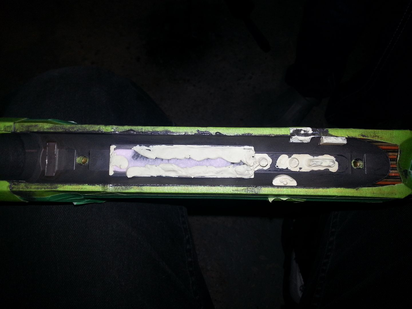

Here is a pic of the jig I made to drill for pillars. And the bedding job after I popped the action out.
