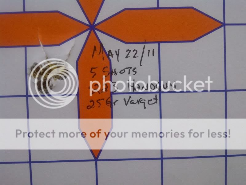

This is the target i shot a couple weeks ago, so far I have found the Hornady V-max have produced tighter groups.
What do you guys think, will the groups be just as good or a bit better with the bullet seated longer?
I will also make adjustments to hit the bullseye.
T/C Super 14 .223 1:12 twist
Bushnell 2-6x42mm Scope
Virgin Winchester brass
CCI 400 Primers
25 gr Varget
Hornady 55 gr V-Max
Caldwell "The Rock BR" rest
