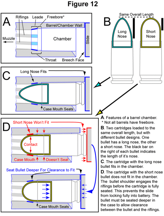

Take the barrel out of the gun and do a plunk test. Set the bullet long so that the bullet engages the rifling (i.e. it fails the plunk test). Then seat 20 thou deeper and see if that works. Repeat if required. You want to be sure that the bullet is well clear of the rifling. Note that this is required for each different bullet brand, shape and weight. Note the length that works for each bullet.

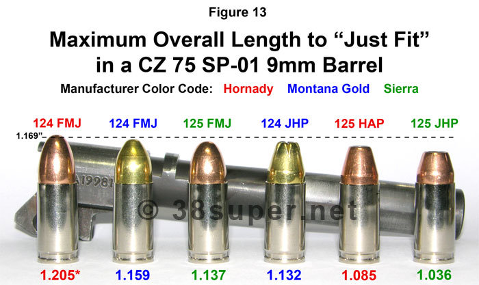

Ganderite provided some good advice. I would add that not only should the max OAL be determined for each different bullet brand, shape, and weight, you'll also need to check it in every barrel you plan to shoot that ammo from. For example; I know that my CZ Shadow requires the shortest OAL of any 9mm handgun I own, so I load everything to fit its barrel. With a 147gr CamPro, that would be an OAL of 1.08. That makes life easy for me, but if I didn't load to my shortest barrel, the max OAL would vary from 1.08 - 1.15 depending on the handgun. Another consideration would be magazines, but generally you only need to worry about that when loading really long.

To help with visualization, here's a trio I post often on this board and others. The CZ specific information is just meant to show how different profiles in the same barrel load at different lengths. That concept will apply to all bullet/barrel combos.
Thanks 4N2 for your last post. Worth its weight in gold. Like I side the BR guy in me is thinking more BR than anything. With a pistol it is similar to rifle load development but bullet placement in the case to ensure proper bolt closing and function is paramount in a auto loader. Until you actually talk about it you miss certain steps that are key to load development and safety.
