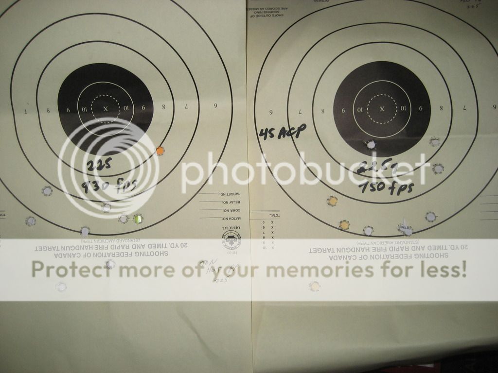

This one shoots low. It is a Tanfolgio, so I don't happen to have any alternate sights in my junk drawer.
I tried both the 200s and the 225s to see if one shot any higher. No luck. They both shot about the same.
There is a theory that a slow bullet will hit higher because the pistol has more time to flip. So I tried that.
Same 225gr bullet. A load so mild it barely runs the action (750 fps) and a max load of Power Pistol at 930 fps.
They both shot to about the same place, about 3" low.
Looking for a taller rear sight.
