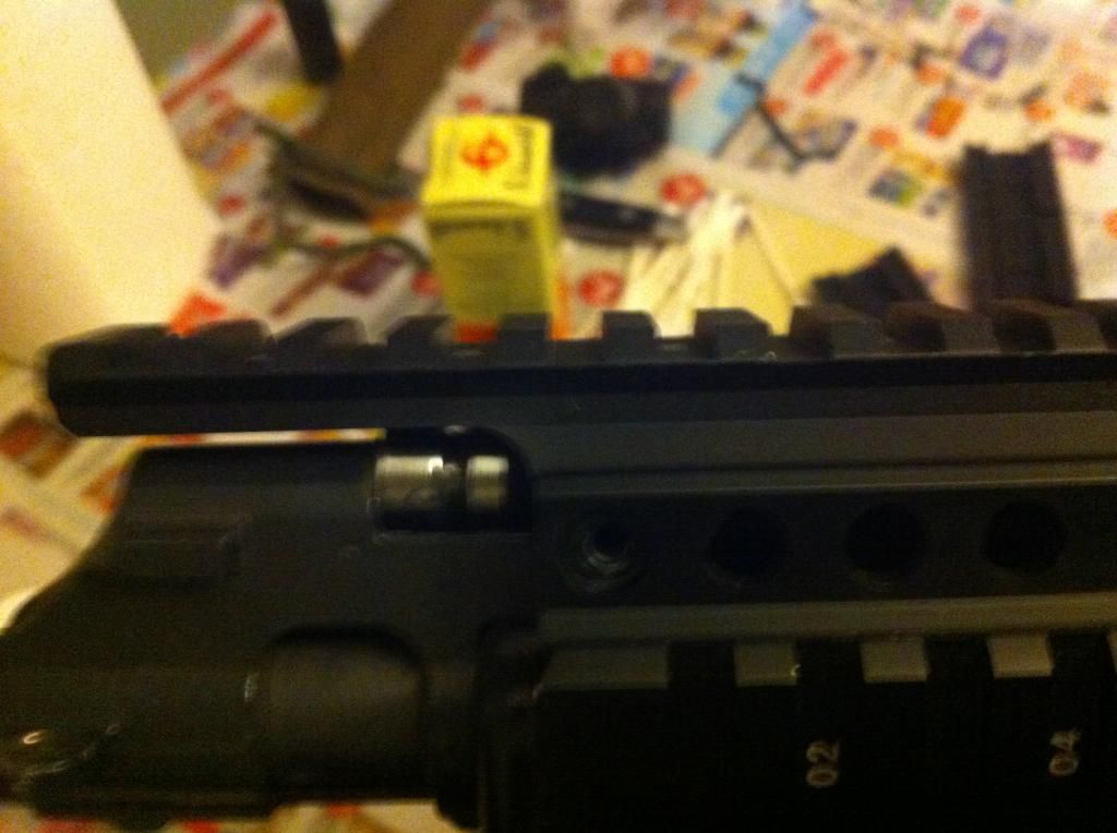

Update today. Had the rifle out and shot the usual surplus stuff. The gun did the same thing which rules out the ammo being the issue. I recently put a aluminum quad rail on which is the only other change. Could it be a worn out spring or bent piston? Everything else about the gun is the same. Ive put 600 plus round through it since new with not a single issue....now it wont cycle without this issue. Have pictures but cant post them basically imagine the piston hung up on the lip of the gas block
I had this issue, turns out an aftermarket quad rail had slightly deformed the gas block, had to take a file and clean the edges of the gas block then it worked fine.

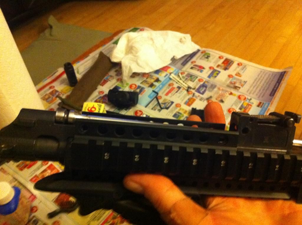

Ill have to check out the gas block more carefully. The quad rail I have doesnt attach anywhere to the gas block but maybe there is something going on in there. Here are some pictures of what it looks like when it happens.
To me that looks like the rail that hit the market a year or so back that was sold for the CZ 858 and VZ 58 family but there were issues with the rail not being properly made for this rifles.

That upper handguard just looks wrong. I have the BC tactical and it has the 2 prongs that fit snugly under the 2 tabs on the gas block just like the stock one does. It also forms a full cover over the piston at the gas block end. Based on the first picture, does it expose the piston when you have it installed - sure looks like it??
Can you post a pic of the whole upper rail - it almost looks like an AR rail mounted backwards....
There is a link on page one to the ebay page that has some pictures of it installed. The rail system clamps to the barrel on the inside. It does expose the piston more than other rail systems ive seen. I never considered that to be much of an issue as I thought the upper hand guard wasn't even needed for proper operation. At the end of the day the price was why I bought it, the plastic fab fore ends are a joke (no offence to anyone who uses them intended) and the other aluminum rail systems aren't worth the $300-400 for me. I wanted the bonesteel set but he couldn't me an idea as to when he would have them back in stock. If I cant get this rail to work then ill go back to stock and wait for bonesteel to ship me theirs.
