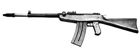

Here's a better idea: blow forward action!
Here's an actual rifle with this action, the Sig AK53:
One would think this system would have 2 advantages:
1. Cleaner
2. Lighter - no extra parts
