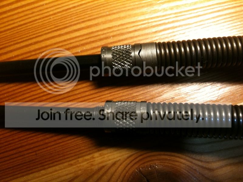

I ordered mine from Al Simmons, who go through an importer out of London if memory serves. Great rifle and very accurate, but be wary of one thing. CZ had a factory run of 550 standard calibres with a crappy firing pin spring retaining nut arrangement. The nut is held onto the firing pin by a tiny wire clip, that broke after a few rounds on many, many rifles, mine included. Has been a HUGE pain in the ass to fix. Mine is now a safe queen til I can figure out a cost effective means of fixing it. Switched to a Win Model 70 sporter I like just as much and shoots just as well.
My 550 safari has the old standard 2-piece nut which has apparently gone back on the standard models, because of so many issues with the clip breaking. Be sure to have a look at the firing pin before buying, if you can.

Overall I really like the CZ and would recommend it, but only after making sure it has the 2-piece firing pin spring retaining nut.
Top one is the 2-piece, bottom the 1-piece. The 2-piece is the one you want. Avoid the other one like the plague.
Does anyone have a serial number range that had the one-piece firing pin? Or will LeBaron let me check in-store?
Update: Checked, it's the bad pattern firing pin. On CZ's webshop, the replacement firing pin assembly for the standard caliber 550's is that one piece, while the magnum is the two piece. Are they interchangeable or something?
