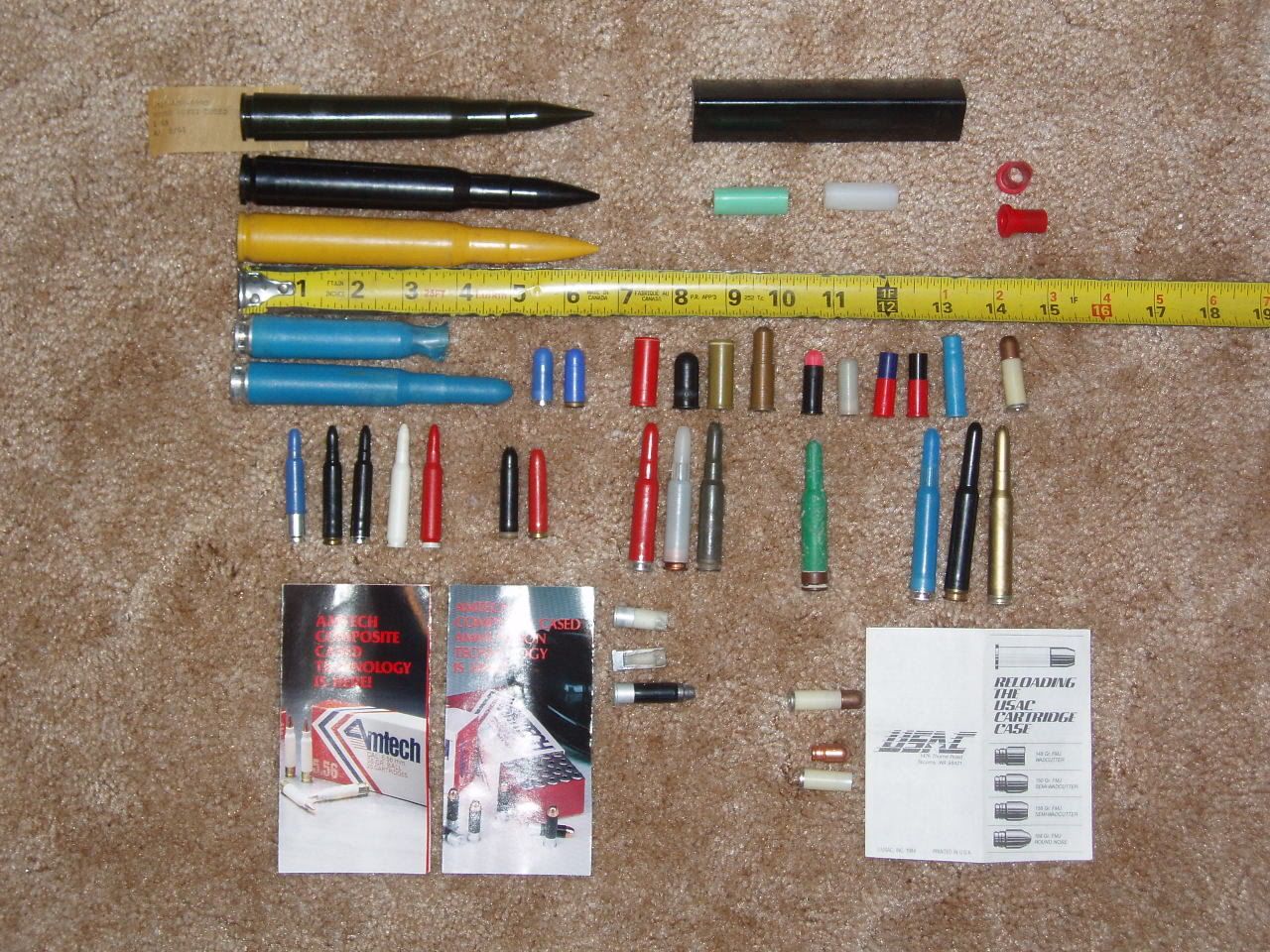

Back to the original subject, plastic cased ammo, he is a bit of my collection.
The big rounds in the upper left are dummy training rounds for the wooden double scale Garand training prop used by the US Army. The rounds are double scale 30-06
The big black thing, and the smaller greeen and the white things are "trounds" for the Dardick gun. (Google Dardick for more info) The large one is a dummy in 50 cal, for a USAirforce experimental project.
the red thing beside the trounds is a plastic shotshell for a CO2 powered shotgun.
Below the tapemeasure is mostly blanks and short range training ammo. the big blue ones are 50BMG, one is intact, the other is fired. You can see the bullet part has broken away on the fired one.
To the right and below are various blanks etc.
At the bottom are samples and brochures from USAC and Amtech
