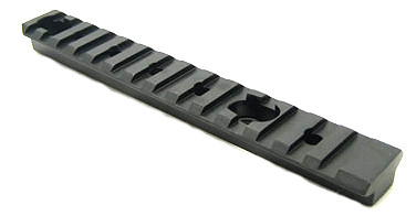

Aweaver style base (1 or 2 piece) is the type that you mount weaver style rings on. The rings clamp on to the base and the base has a groove to keep the ring from moving.
Pickatanny rail also uses weaver style rings but is always a 1 piece and has multiple grooves to allow mounting of different optics. Can also be canted for long range applications.
a dove tail is machined into the reciever of most 22's and 22 rings clamp onto the dovetail, no base required.

One piece weaver rail
weaver mount will need two for a rifle
All of the above will need to be screwed to a rifle's receiver, some firearms have the rail integrated into the receiver (Ar-15 flat-top).
