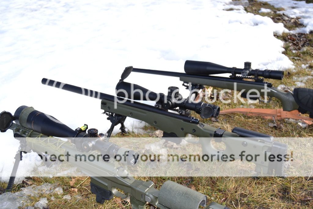

I have a Coyote and a Siii
You can use ( and I recommend ) TPS 30mm High or the Vortex ( which really are Seekins Precision ) 30mm High
Photo showing the Vortex rings being used
