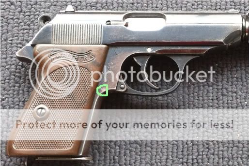

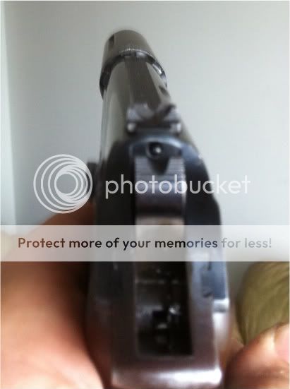

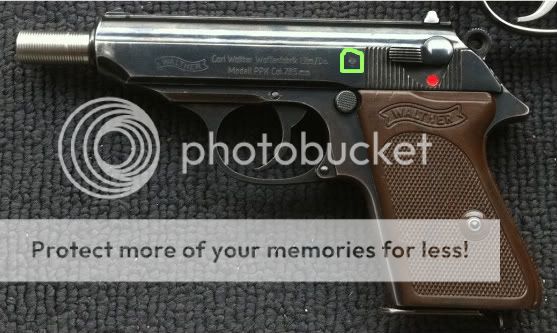

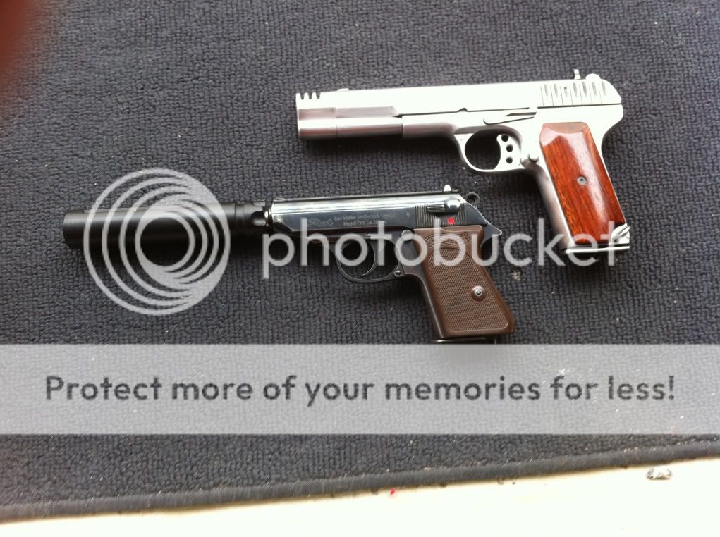

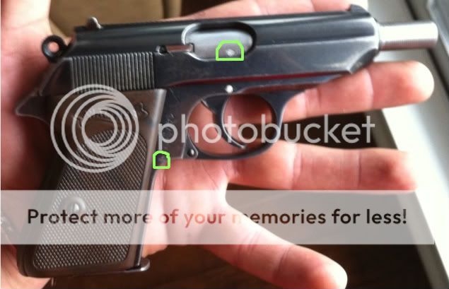

I just bought this Walther PPK, rebarreled to restricted length. i would like to find out what year it was made, but when i searched the serial numbers.. i couldnt find anything. The serial on my gun is 147### only 6 digits without any letters.(last 3 digits on the pictures are smudged in photobucket), also that is the only place on the frame that has a serial number, at least from what i found. There are 3 "nazi eagle" marks in different places (circled green)
Here are the pictures...
Any ideas..???

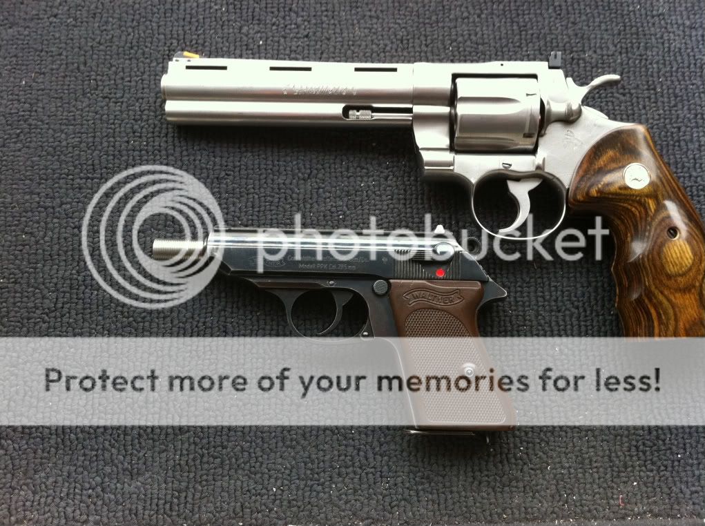

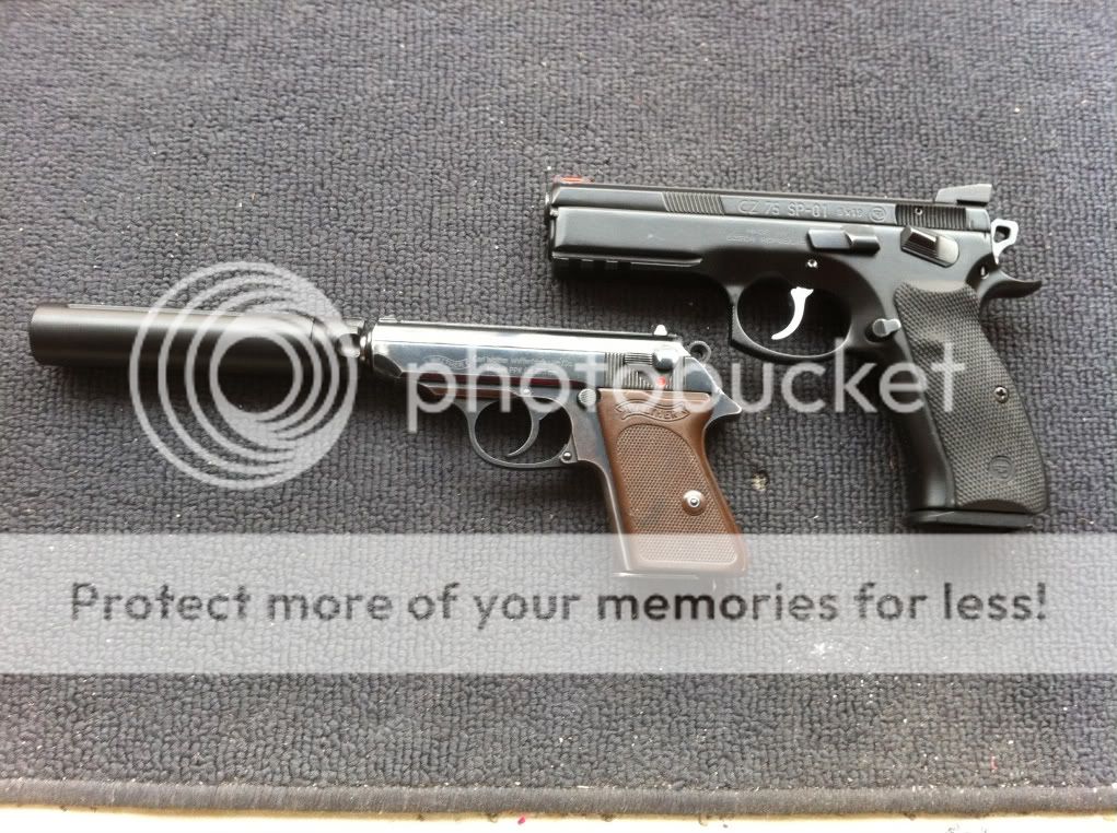

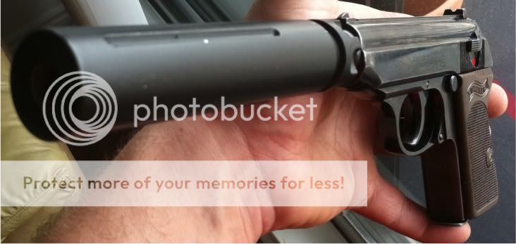

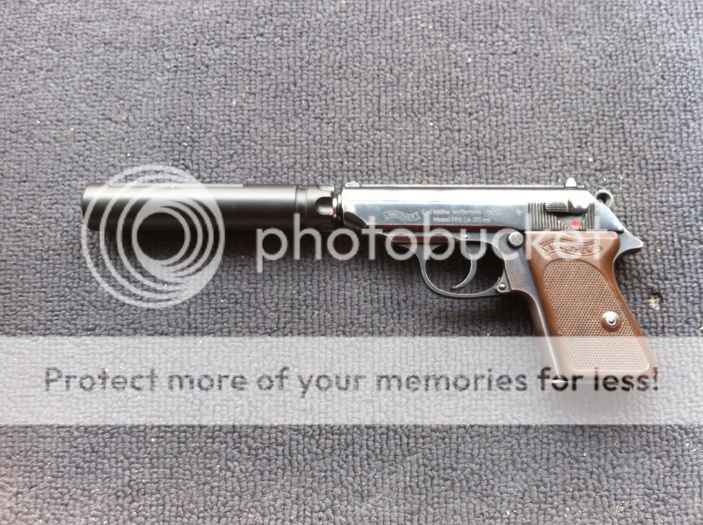

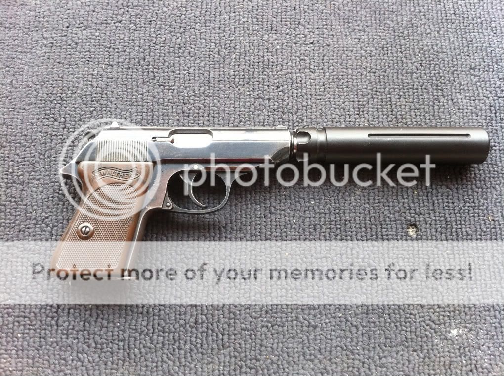

Ok, i couldn't hold my self... here are more pics...:) Fake Can... :)
And for size comparison.
Enjoy.. :)
The German Eagle vs. Nazi Eagle are sometimes hard to tell apart but, depending on when it was made, most PP and PPK pistols have a marking on the barrel shroud that you can see through the ejection port, with a symbol and two numbers. The numbers (eg. "65") represent the year the gun was made.
Your slide is marked ULM, so made post-war. A large number of post-war Walthers are made in France by Manurhin and simply marked with all the German markings. In Europe, where the pistol is "proofed" (those eagle stamps) is where it is "made". Don't worry, the Manurhin PPKs are very nice, as yours is, and work excellently well. According to Dieter Marschall's book Walther Pistols, From 1954 to 1985 all PPKs from serial 100,000 to 329,000-some were Manurhin made and Walther proofed. This fits with what other people say too. At some point they started finishing the pistols in Germany (Ulm is very close to the Manurhin factory) and eventually took over complete fabrication in the later 80's.
If all the eagles are the same (frame and slide) and there is no marking of year manufacture on the barrel shroud, then you have an early (50's) pistol. No serial number on the slide means it was never in military or police service, since it seems those agencies all insisted on every part, including the magazine, being stamped with the pistol's serial number.
7.65mm caliber marking means it was, like most PPK pistols, a .32 when it started out. To convert it from prohibited (caliber and barrel length) to restricted (longer barrel and new caliber) it was obviously rebarreled with some additional work done (headspace opened a bit and probably the slide's barrel port opened up a bit to accept the thicker .380 barrel). The ejector also needed to be ground down, or changed out, to let the bigger .380 go by. That's the part that sits to the left of the magazine well (looking down with the pistol pointed away from you) and also serves to lock back the slide on empty.
The pre-war and wartime .380 PPK used bottom magazine releases, since the recoil would jolt the magazine loose. If that happens to you, you can get a stronger magazine release spring, or there may already be one. For some reason, Walther PPs and PPKs recoil much more than most .380s. There's a guy on watherforums.com doing a study as to why.
The magazines for post-war PP and PPK in .380 are ribbed on the left side, where a small extra magazine follower part contacts the ejector / slide stop. If your magazines aren't ribbed, the ejector has been hand fitted to allow the .380 bullets by, but to still contact the magazine follower on empty and lock open the slide. That means, if it ever breaks, the replacement needs to be fitted again. Not a big deal, but careful work. Also, don't buy modern "380" magazines for this pistol, since they won't fit. You need the .32 magazines, which, again, hold .380 just fine.
So 50's gun, commercial, in nice condition. It looks like you have the original wrap-around 50's grips, before they split them at the back. Zehr Kool, ja!

The OP's pistol looks like one of the police turn in guns that came over in the mid-late 80's. You could get one in the box with spare mag for $150 (I had one as my first 'registered to me ' gun when I got my FAC at 19) Strangely enough, the world didn't end and no one died when one of these deadly weapons was owned by a 19 year old from Surrey. Very cool conversion with the fake can - nice!
Good information from "dan belisle" and "gunzik". I would amend just a bit. Pre-war and wartime PPKs used the button magazine release. "gunzik" is quite right about the meaning of the Ulm-Donau marking. I can't see the same detail that he can, but I agree with what he wrote about the work necessary to convert the gun from 7.65mm caliber to 9mmK. It looks to me like an early post-war gun, so a manufacturing date in the 1950s sounds about right. Nice acquisition.
You got a post war PPK.
Just check the adress, which is Ulm/Do, instaed of Zella-Mehlis.
The Nazi eagle you refer to is in actuality the "Bundesadler", symbol of the Federal Repuplic of Germany.
