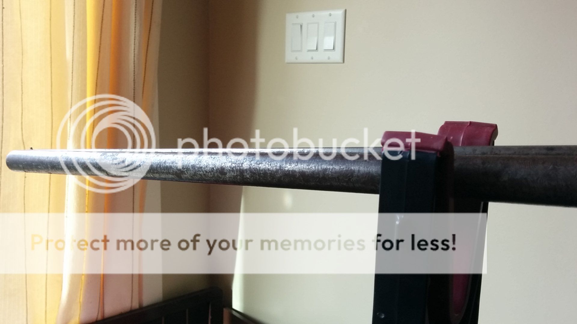

Hi, I just was given an old Remington 1894 SXS from my Grampa's estate.
I'd like if an expert could chime in and provide me with some info on the gun, and also thoughts on what I should do with it.
Barrel length was measured at 29 3/4 inches
Serial number was 117854
Here's the pics
Scroll work all down the barrel

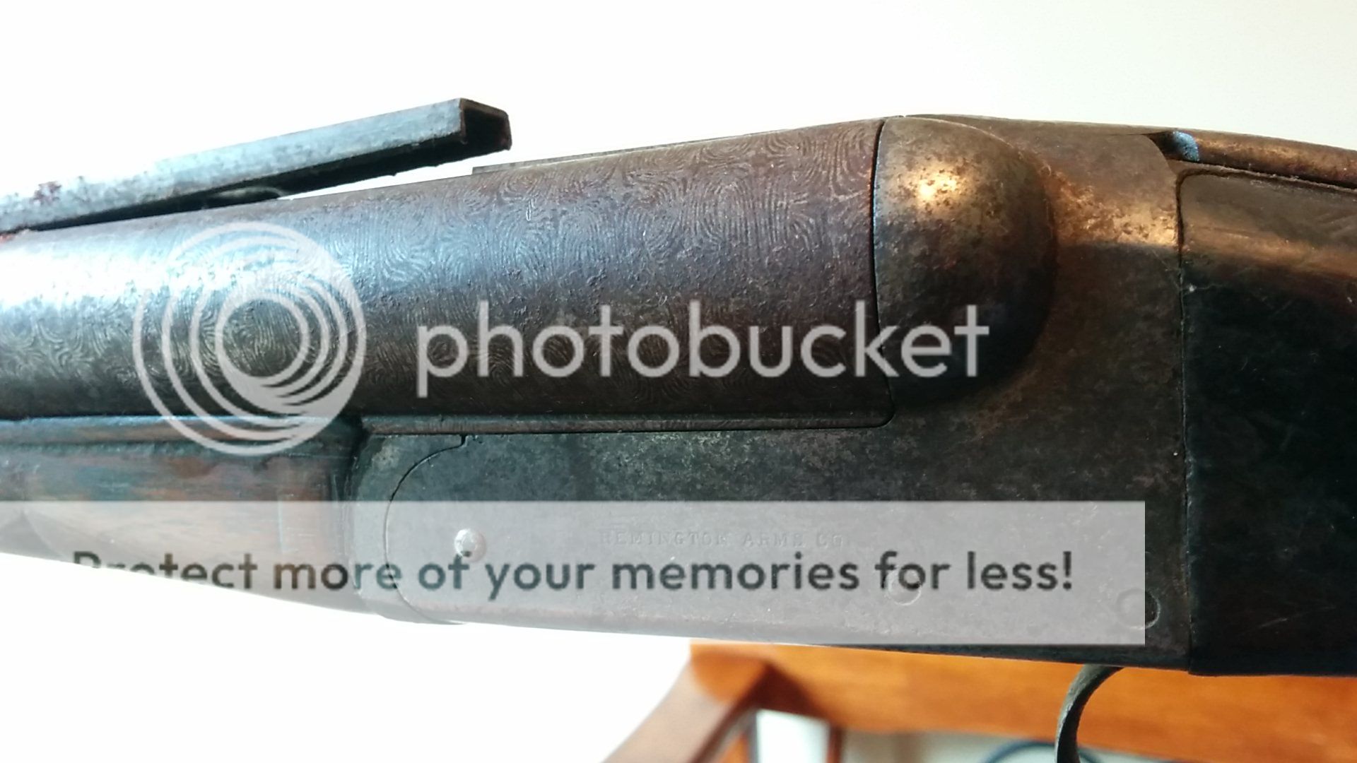

Nice tight fitment, rib has come detached

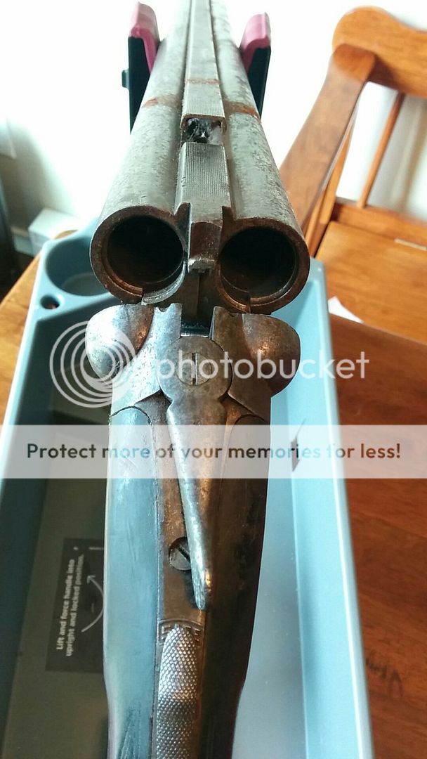

Ejectors and safety

Your best bet I'd yo give her a cleaning and hang her up to enjoy looking at. Seems to be a bit if s gap between the barrel and the receiver. And yes the barrels are Damascus not fluid steel. No modern shot shells threw this one ..Dutch

This is a well used and not well cared for Model 1894 A grade made in 1900. As has been pointed out, Damascus barrels. In assessing an old gun like this, the first and main thing to consider is the state of the barrels. Everything else can be fixed, if one wanted to. Are the barrels original or have the chokes been changed, the chambers lengthened, the bores honed so many times the walls have become dangerously thin and are the bores pitted.

Fix the rib. I haven't had to do this on a gun yet but it is really not going to be cheap. My guess to remove, repair and relay the rib, at least $400.
Re blacken the Damascus. $500-$600 These barrels would have left the factory with Black and White Damascus barrels.
Redo the stock $500 Would include repairing the cracks properly...yes there are cracks, removing the accumulated oil that is soaked into the head of the stock and is weakening it, glass bedding the stock to create a proper new receiver to stock fit as well as strengthen the wood
Strip and clean the action $125.
Put it back on face $250
Refinish and CCH the receiver and bits. $300
All that is also assuming the mechanicals work properly, hammers #### and fire, safety works. Any problems there and it's just more money.
