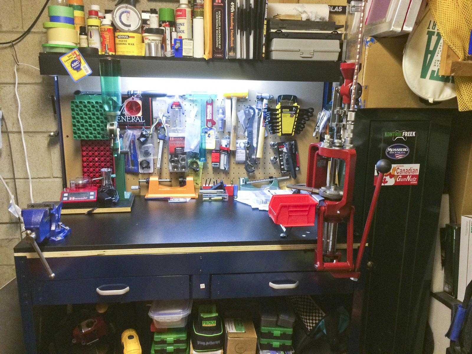

This is my setup. The work bench comes on sale at Canadian Tire every now and then. I'm now using 2 of them. The presses can only be mounted on the ends to clear the drawers. The Forster fits perfectly in the middle, not the RCBS. The RCBS press is now mounted to the far right, it gives me more space in the middle.

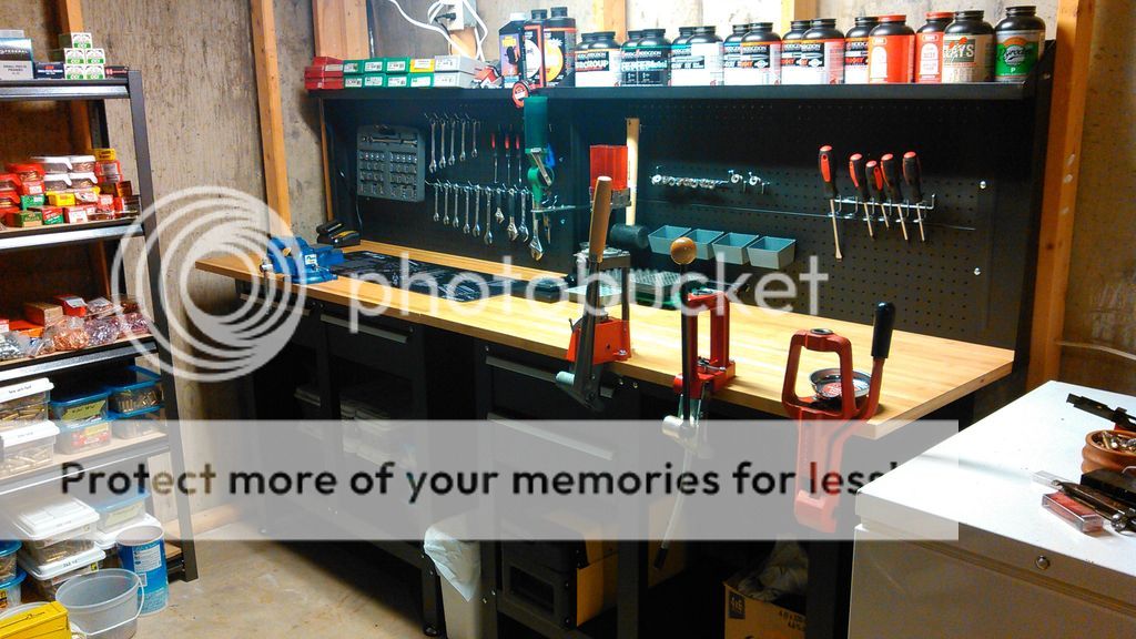

Did the same thing, they were on the damaged rack for $99 a piece because the bamboo top had a few tiny splits, I re mounted one of the drawers underneath the other and put the presses on one side, bolted both benches together as well, very heavy duty and sturdy!
Looking good! I wish I thought about the drawers like that, it's on the to do list now.
