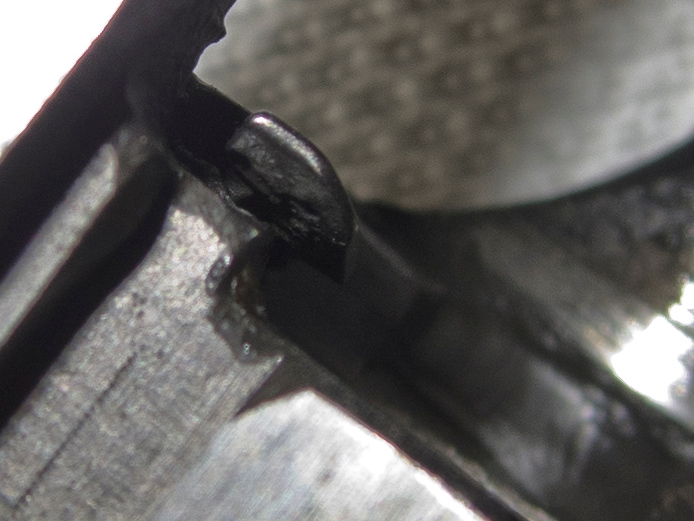

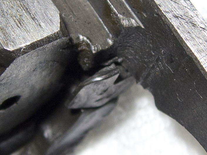

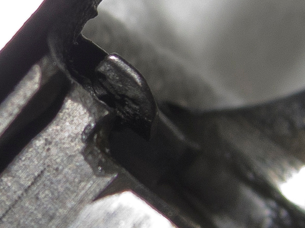

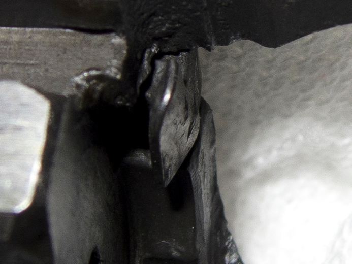

Are these photos good enough for you guys to see if I need to modify my extractor? If not I can try get better ones. I don't own the tools necessary to remove it:

You have tons of gunk between extractor and slide - most likely factory grease.
I'm gonna take pix for another forum member on extractor and spring replacement process and what I smooth out on mine. I'll post them here in a few days.
Mark..buy a punch kit..small hammer and remove it....clean it. You have never cleaned it as you stated you do not have the proper tools to clean it. If it were an HK, or Glock, i would not clean it as often...but with CZ, tanfoglio, etc...I would clean it at least every 1000rds.

I have not done anything to my extractor, the shiny part you see is just the camera flash, it doesn't actually look like that. The only modification is a #13 mainspring for a lighter trigger pull.
What would a stronger extractor spring do for me? Also, I'm hesitant to change the recoil spring because my gun ejects the rounds nice and hard as it is.
I will pick up some of those tools and give my extractor a good, proper, clean next time I am at the range. You guys are right that the extractor hasn't been cleaned since new, because I was never able to remove it, so there is probably packing grease in there.
I think where my head is at right now, I need to remove & clean the extractor, and try some different ammo (PMC) before I start making modifications.
