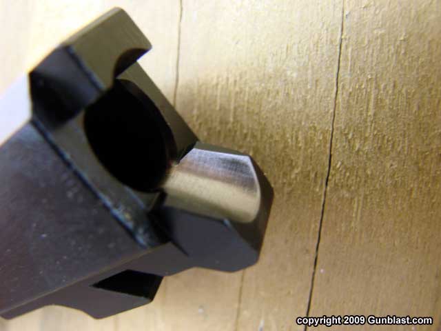

If the interior of a receiver has a 'blacked' finish and you polish the feed ramp and remove some of that black finish is that bad ? Is there a negative to it Besides the finish looking bare? ( corrosion?)
Here is an example :
If you want to give it back the colour then wipe it down with some cold blue. Or just shoot a couple of mags and the soot will cover the spot.
There's no downside to leaving it shiny though. Yes it's at risk of rust but then so is the black finish on the rest of the barrel if you forget to oil it.

I opted to leave it unblued - it's not like blueing it will protect it more so I don't mind that the ramp is shiney
