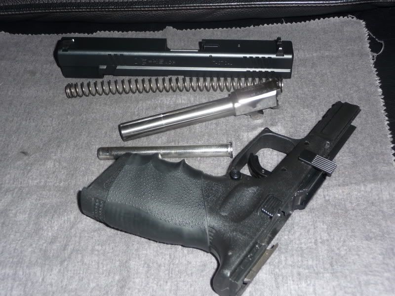

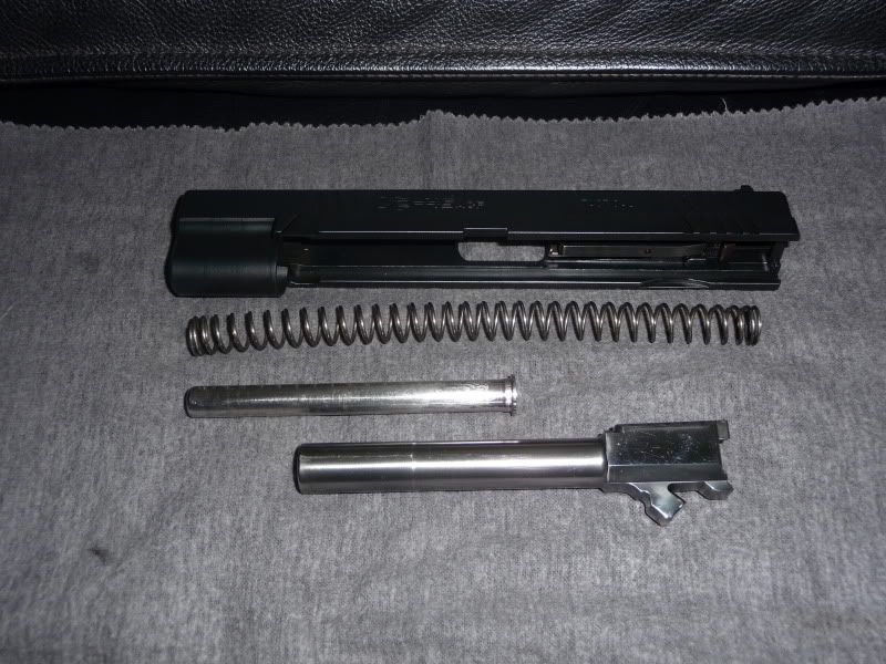

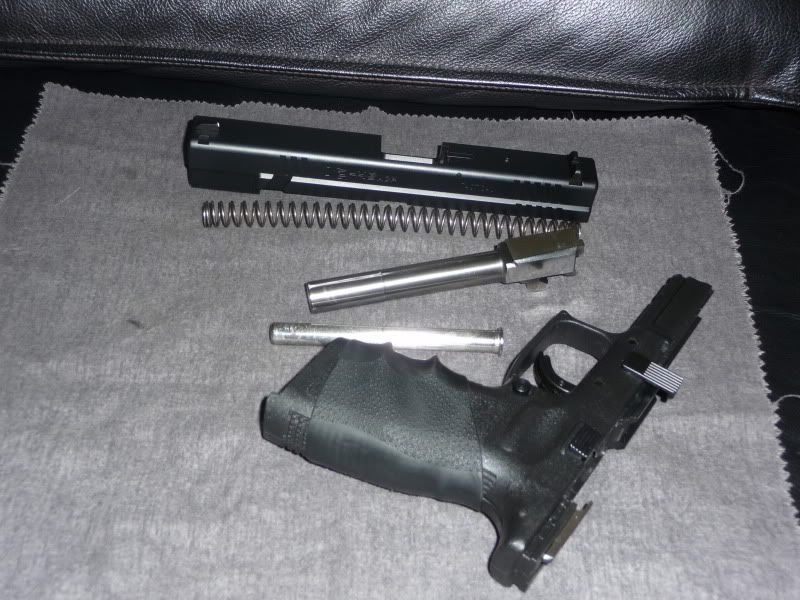

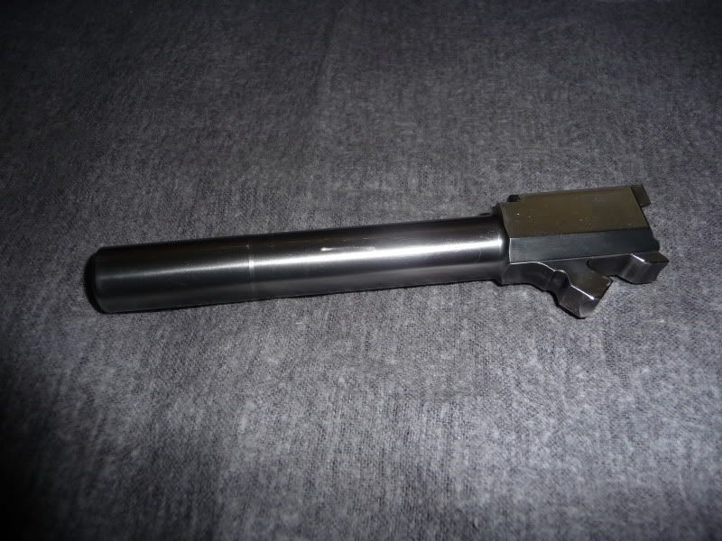

enjoy have fun, here is my polishing on my XD, and the last pic is some painting on the slide as well
