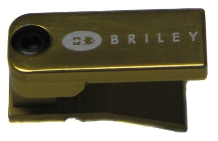

Im surprised that no one has mentioned the Briley ones. I put one on mine and LOVE it.

Then don't use the drift pin hole they use the actual bolt release hole. They consist of a front and back that screw together with a hex headed screw and are to be Lock-Tite'd in place. No chance of coming loose.

dilly mentioned one in post 5 on this thread. I would be hesitant to try one if I had to lock tite it in place. This comming season I am going to look for the different type of add ons available for the 391, but til then I think CB's plan to stick with the stock bolt release is the winner.
Me too. What appealed to me about the Beretta product was that it swapped in and out easily and was low profile. The others seem to stick out a little more from the receiver, are more complex to install and/or harder to remove.

It's a backplate that sits in a channel inside the receiver, and protrudes through the bolt release hole. There is a square post that the top plate fits over to make sure that there is no rotation of the release lever. The connection is firm, and you tighten with a hex wrench. It is recommended that you lock-tite the screw in place, but i'm sure that it will stay in place even if you don't. There is a lot of jolting going on during the normal use of the shotgun. It's worth the $0.00000001 of lock-tite to decrease the risk in my mind.
Works awesome on all the 391's that I see at our club with 'em.
Personal preference prevails though. Good luck on something that makes you happy.
