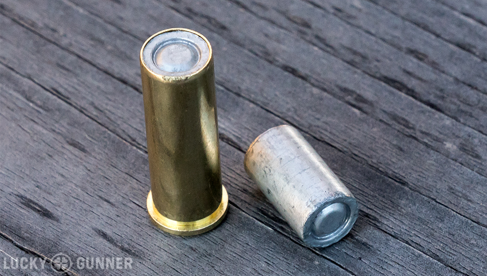

I might have been unclear... Normally the M52 fires ONLY 38 wadcutter bullets that are flush with the case. So the ammo from the side looks like a spent case.
Since I dont have wadcutter bullets (the ones that are complete cylinders, I could have loaded a semi wadcutter or roundnose seated as deep as the wadcutter so that its nose is also flush with the case end. I did not want to reverse the bullet to fly bottom forward.

This is what it needs:

It is a valid point that the case is not cylindrical inside and the best thing to do is probably to pick up some wad cutters and be done with it
