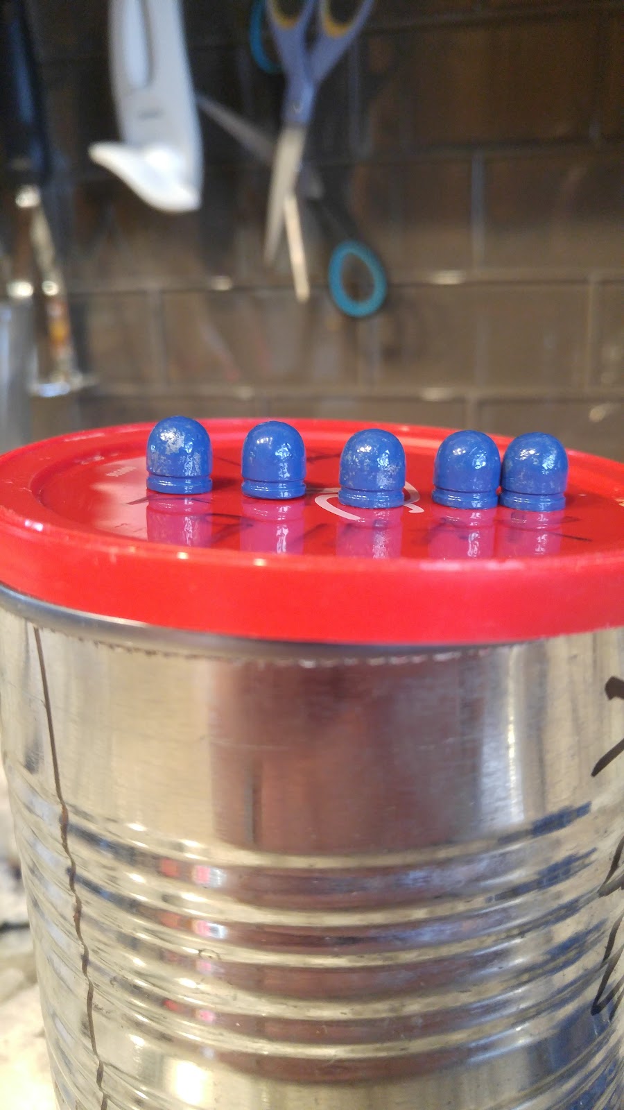

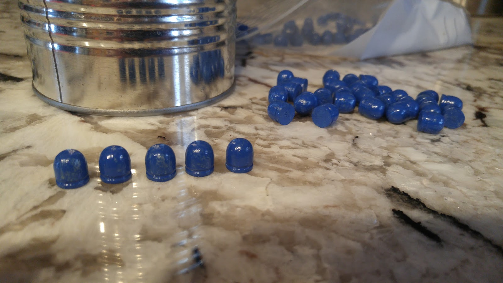

Here is some powder coated 9mm Makarov I processed for a friend. As you can see there is not much body for both lube and crimp, and the lubed bullets were being problematic during feeding. Hopefully this will help with the feeding problem. I used the shake and bake method with Princess auto blue, its not perfect but it should do.

the 9 Mak is a prohib 12(6) in 9X18 case, projectile .365, about 95 gn lee mold. The problem wasn't feeding, but to find a way to lube and size. I tried some as-cast with lee alox, then oversized a sizing die to .364, but bullets are short and difficult to start straight. I loaded the sized PC bullets with 2.7 red dot, they stay in a 6" black at 25 yd, 2 hand supported, not bad for a full blowback pocket pistol.
