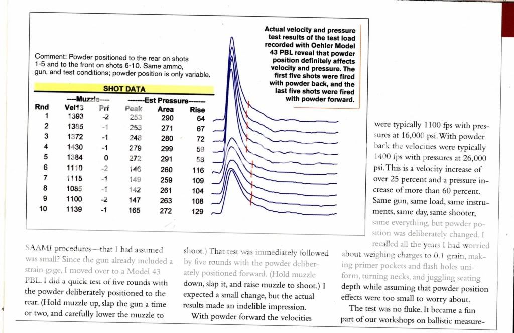

If you note, the EXACT same 38 spl load varied in peak pressure and velocity, depending on where the powder was sitting in the cartridge case.
  • Pressure from 14,200 psi to 27,900 psi (38 spl pressure is 17,000 psi, and 27,500 is max proof pressure)
  • Velocity from 1,100 to 1,430 fps
Remember this is the EXACT SAME LOAD in all tests. So those people who doubt that a KABOOM can't happen with some powders or light loads should consider these results.

Again, I could be wrong, but my impression of this whole question of powder position is that, unlike the theory of detonation, low powder charges won't create disproportionately high pressures, they'll just create lower pressures the farther they are from the primer. That's what your article seems to say, as well.
This has also been my experience. My .38s loaded with Green Dot only shot slower when the powder was farther away from the primer, they didn't create pressures above what was expected due to powder position... I'm not convinced any of this has anything to do with the dreaded "detonation".

1) I believe that some of the "dreaded detonations" were actually caused by effects of powder location in cartridges. This article clearly shows that position can have a dramatic effect.
Powder companies have tried to duplicate "detonations" and not succeeded, so this theory may offer a better explanation.
2) The comments about light loads in bottleneck vs straightwall cartridges can also be looked at another way. Straightwall cartridges are that way because the bullet diameter is large. This larger diameter creates substantially greater volume behind it as it begins to move, lessening the effects of a pressure peak.
A bottleneck cartridge, by definition, has a small diameter projectile, which has to move MUCH further along to create volume to reduce a pressure spike. Hence, pressure spikes in bottleneck cartridges are MUCH more severe than in straight wall cases.
3) Yes, a volume of powder can only produce a certain volume of gas, but the important thing is over what time period is that gas produced. Over a shorter time period at the beginning when total chamber volume is small = higher pressure peak.
4) The "location" of the powder within the case will change the way the primer ignites the powder. I theorize that unconstrained powder against the flash hole will tend to ignite a greater quantity of it when the first part of the primer flame easily/quickly disperses it (greater surface area of powder burning) resulting in the observed pressure peaks.
