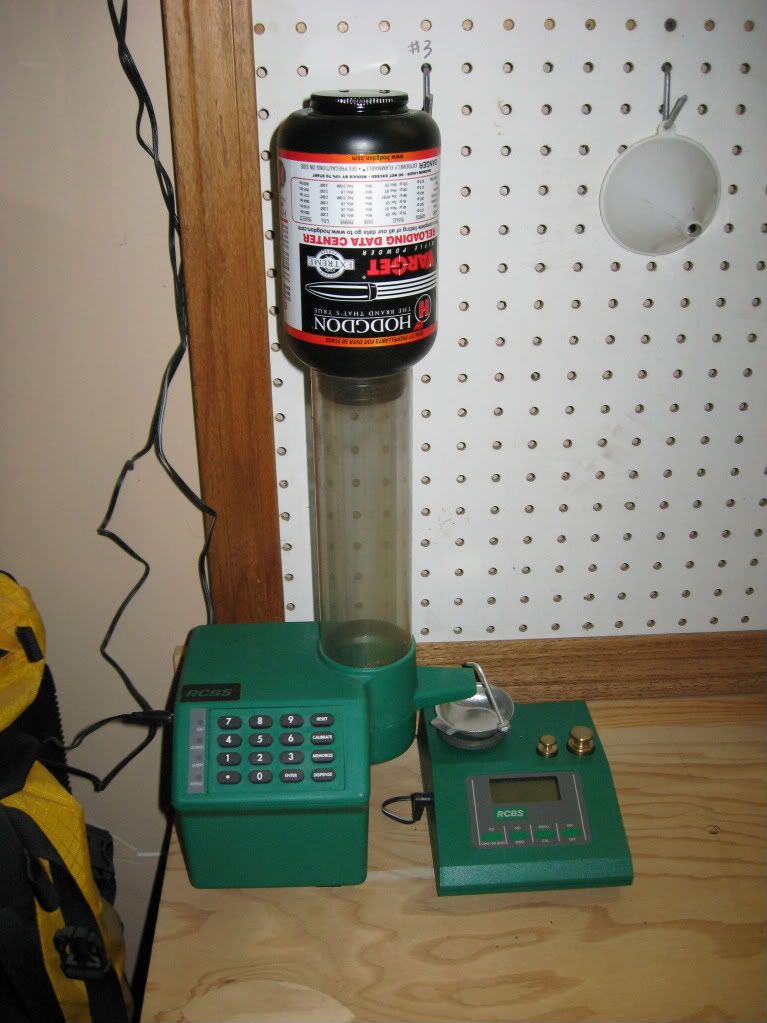

How I keep track of what powder is in the hopper
When I'm using a powder measure and leaving powder in the hopper, I always put a sticky or a piece of tape with the type of powder on it on the lid or facing me.
