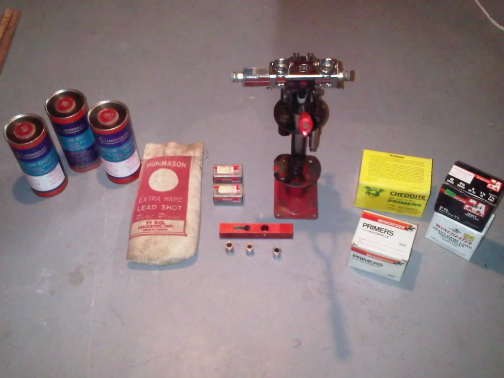

Just bought a second reloader MEC. When I got it, it came with tonnes of extras, which is the reason I picked it up. Included was three can of Hercules Blue Dot Powder. All labelled 1992 on the bottom. So here are the questions:
1. Will this powder be good? Cans seem to be sealed still.
2. Where do I find reloading data for it? All I find is Alliant Blue Dot, did the company change names?
3. If you are or have used this powder what are your receipes, I would like to put it behind 1oz of 7.5 shot
4. This is just general what do you with you empty cans? Just toss in the garbage? or something special
Any help would be appreciated
Here is what I got $50. I know it's not complete but it had. The universal charge bar. Hope the link worked did it from mobile.
