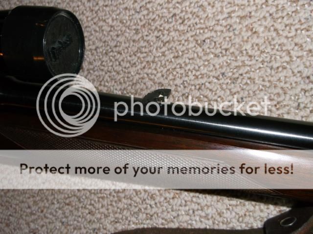

No front sight and no holes, but has a rear sight dovetail with a blank?

The safety is off a pre-war rifle, why they would change it I have no idea. It kind of makes me wonder if the bolt is original to the action. You already know the pad is not original, and neither is the blueing on the receiver. The front sight has been removed, and there should have been a folding lyman style rear sight. It looks to me like the stock has been given a coat of varnish at some point. If you look in the magazine well, it should have a short follower if the action was originally .243. No collector value, but it should be a good shooter, or the basis for a custom project.

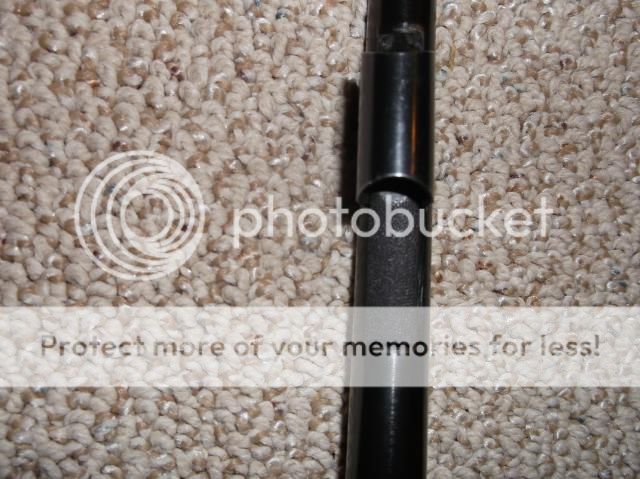

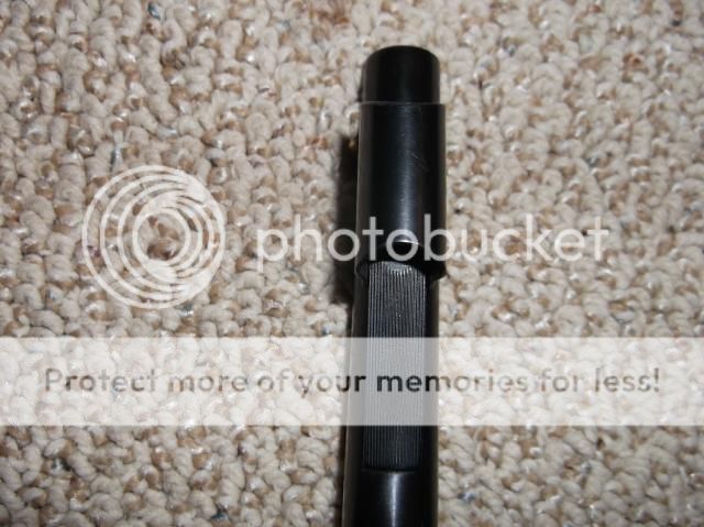

The ramps weren't screwed on, they were soldered in place. Meaning the barrel has been reblued as well, or there would be a big silver patch at the muzzle. On the older M70's, pre-1953 I beleive, the ramps were machined integral with the barrel.

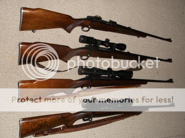

I took 5 pictures with my phone, not the best, but good for comparison. .The second from the top is a 243. . The second from the bottom is a very early f/w with the integral front sight. The picture will show stippling on the sight ramp. . The other 3 have the soldered on sight bases with a grooved sight ramp. .
Mac: . . From your pictures it appears the stock on your rifle is a tad short including the buttplate arrangement. . Look closely at the pictures I posted and judge the distance from the bottom of the buttplate to the sling swivel. . Also, the distance from the top of the buttplate to the raised portion of the comb. . The only featherweight that came from the factory with a recoil pad was, the late entry, the 264 Winchester Magnum.. . But I have seen a few featherweights with patent dated Winchester recoil pads that looked pretty clean. . You can purchase the reproduction pad from Connecticut Shotgun (around $40 plus shipping).
